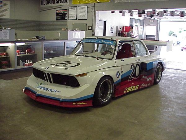

ok so we have a 320 tamiya kit:
http://www.tamiya.com/english/show0210/photo/nm_sc7.jpg
I have been hunting the flares for the above kit for quite sometime for my 74 bmw 2002 which looks like this in full scale
http://www.automotiveforums.com/img/members/02race800.jpg
Now what would be the best aproach to upscale this for measurments/angles to make molds. this is probally nutso bet hell I will give it a try :)

Jay!
06-17-2003, 10:04 PM
um.... make drawings from measurements taken from the kit (mark a 1" scale), print them on a transparency, pull back the overhead projector until the 1" scale is 24" long, trace plans at 1/1 scale...

First of all, measure Tamiya's base body to see if it is in fact dimensionally correct to the real thing because if it isn't, the flares will be off too. :smile:
MPWR
06-19-2003, 12:37 PM
I'm not sure the dimensions for this aero kit would fit your '02. The base for this car was an E21 320, which I think is a bit larger than a 2002. Get a pair of drafting dividers and an engineer's scale (something that will measure in decimal inches- working with fractional inches sucks!), and multiply by 24. Measure the model, and then compare it to your car. (Use a flexible tape measure, like one for sewing- it won't scratch up the car.) Check non aero kit dimensions- length and with of the hood, length between front and rear axles, etc., to see if the model is a usable as reference for your '02.
By the way, your 320 looks sweet! I snapped up the first one of these I saw, too.
Good to see other Bimmerheads here!
