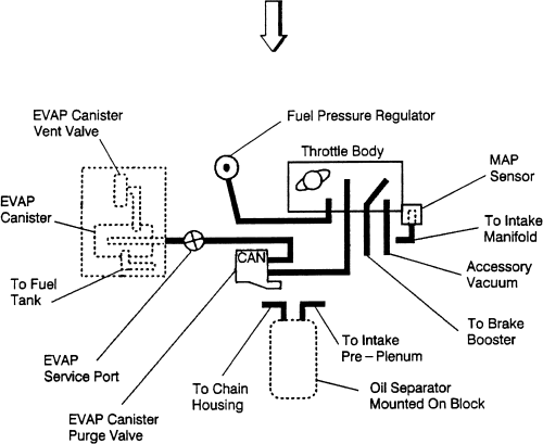

Thanks for the response, but yeah I been told that unfortunately it's no longer there. Someone out there has to have the Service manual Volume one (I have volume 2) which shows the HVAC vacuum diagram. Any help, pictures, drawings, crayon sketch something that will lead me in the right direction.

their is a vacuum canister on the passenger side, under the hood. And the vacuum diagram is right their on the strut tower brace. i'll try and get a diagram of this posted ASAP

xeroinfinity
06-12-2013, 01:29 PM
here is the diagram. i would search for broken/cracked vacuum line(s).
http://i28.photobucket.com/albums/c242/xeroinfinity/auto%20odds-ends/1996-0024LVINTvacuumdiagram_zps1259cd22.gif
azzanione
06-15-2013, 11:20 AM
That did it, found the accessory vacuum line to be cracked, repaired it and now it all works. Thanks for all the help could not have done it without the diagram.

Did you look at the diagram and check the vacuum lines?

Check the one marked "accessory vacuum".....

is it the same diagram on 3.4L? I found some vacuum hose but I have no idea which one controls the heater/ac vent selector..

No the diagram is different.....should be one, on one of the strut towers....
