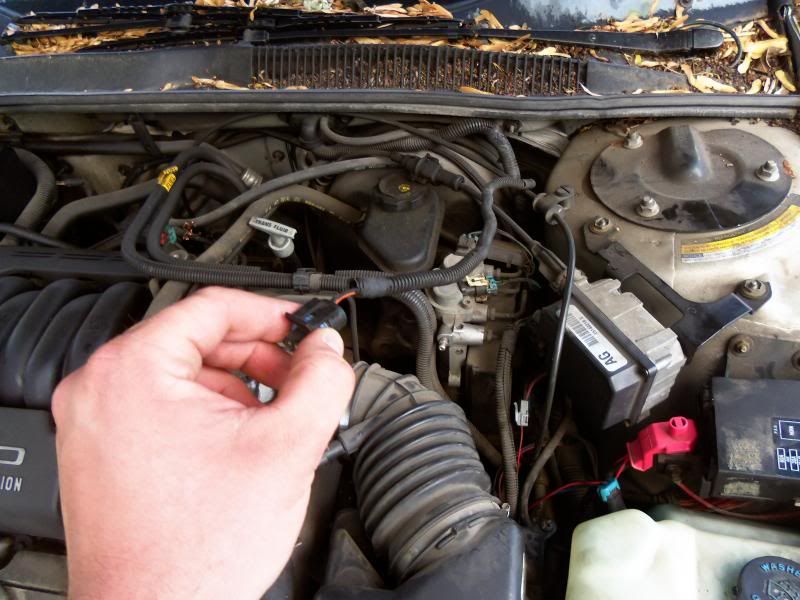

On top of this awesomeness, I found this relay/sensor that seems to go nowhere (picture below). There is also a second something or another that you can see in the bottom right quarter (red wire grey attachment underneath cruise control module next to that bundle of wires) that seems to go nowhere. I didn't unplug these.
Any help would be great because no one ever seems to fix this problem…or at least report how they fixed it.
http://i45.photobucket.com/albums/f62/phayzeshifter/100_1191.jpg

Is it possible what you have in your hand, plugs into the underhood light?
I'm not sure if the other lead is the test lead for the fuel pump......
