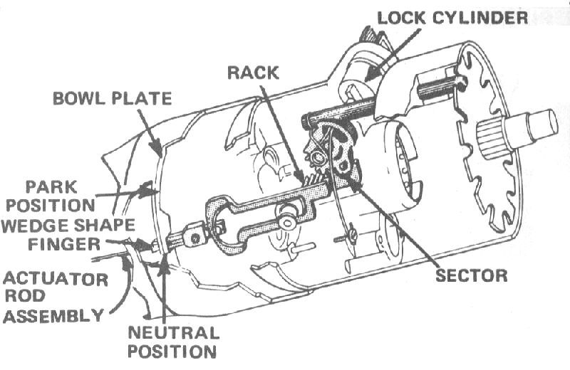

needed to replace the turn signal switch on my 91 caprice. when reassembling i could not seem to get the steering locking mech to engage the way it should. I would like a diagram or photo illustration of the correct position of those parts. if anyone can help with that it would be greatly appricated. thank you. :confused:

This help?
http://www.wwdsltd.com/files/TiltMech.jpg
http://www.wwdsltd.com/files/TiltColumn.jpg

Bowtie, Thank you .... THAT WAS EXACTLY WHAT THE DOCTOR ORDERD...The spring had come out of it's correct placement and without that diagram I would never have known the right placment.The spring is bent into a very perculiar configuration and is actualy all one continous lenth of spring steel. Thanks again! :smokin:
