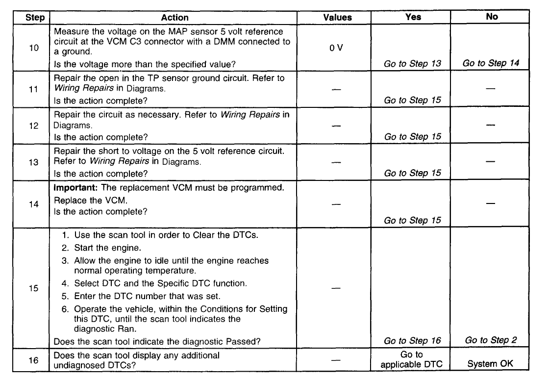

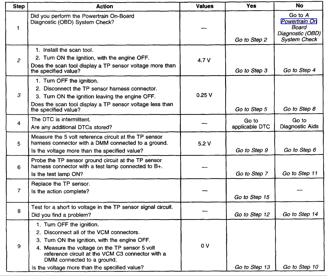

I did go back out today and check the MIL codes, this time they are showing P0123 and P0124 which I believe are TPS errors.
old_master
02-03-2013, 01:15 PM
Do you have the fuel pressure tester? If not, let us know when you have it and we can explain how to check fuel pressure and leakdown.
If you follow this flow chart, (there are 2 pages), it will pinpoint the throttle position sensor DTC's.
http://i11.photobucket.com/albums/a187/swartlkk/2000%20Bravada/P0123_diag1of2.gif
http://i11.photobucket.com/albums/a187/swartlkk/2000%20Bravada/P0123_diag2of2.gif
