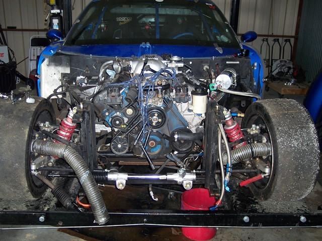

This is rare... don't tell my mother or my wife... but it appears I was wrong. Here's a picture from Eric's album of his fiberglass bodied GTWC... no supports. Guess it's something they added for the plastic cars.
http://www.extremespeedonline.com/gallery3/var/resizes/eric1h/panoz/LS1%20Project/000_0001.jpg?m=1351038513
http://www.extremespeedonline.com/gallery3/var/resizes/eric1h/panoz/LS1%20Project/000_0003.jpg?m=1351038520
