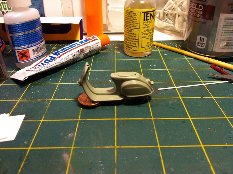

I cut out the part of the cushion where your butt goes, added a piece of plastic rod to the handlebars for the steering. At the bottom of the body I added about 1cm of an aluminum tube for the shaft to go through. There wasn't enough body to drill all the way for the tube. I also added a piece of plastic under where the seat goes. I cut it roughly to shape and sanded it smooth. It's hard to see, but I also drilled out where the headlight goes. I added some Tamiya 2-part epoxy to make a smooth round headlight bucket and formed it with the other end of a paint brush. I sanded a headlight lens from... who knows what kit... to make a clear headlight later.
http://img.photobucket.com/albums/v417/willimo/photo_1_zps158c7075.jpg

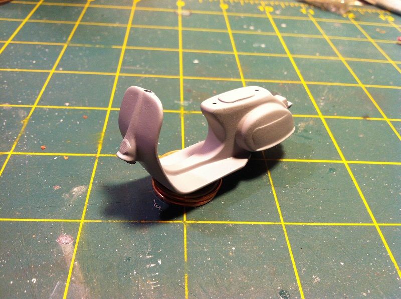

I sanded the spot for the horn flat, and then glued a piece of oval plastic for the top of the fuel tank (under the seat) before priming the Vespa.
http://img.photobucket.com/albums/v417/willimo/photo_2_zpse690861d.jpg

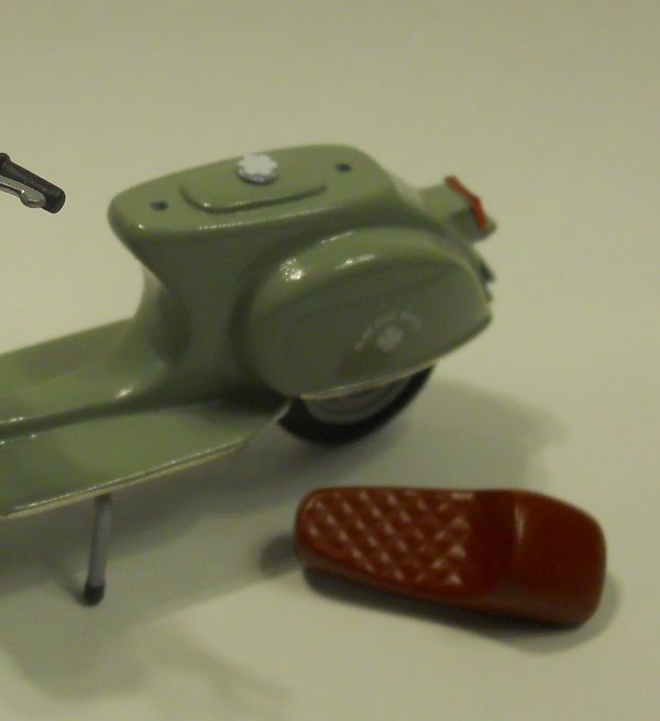

Crummy, out of focus picture of the fuel filler cap, the Racing Mate! decal stolen from the Hasegawa Celica just for fun, and my taillight made from a reflector from a Camaro, I think.
http://img.photobucket.com/albums/v417/willimo/photo_8_zpsa439b680.jpg
