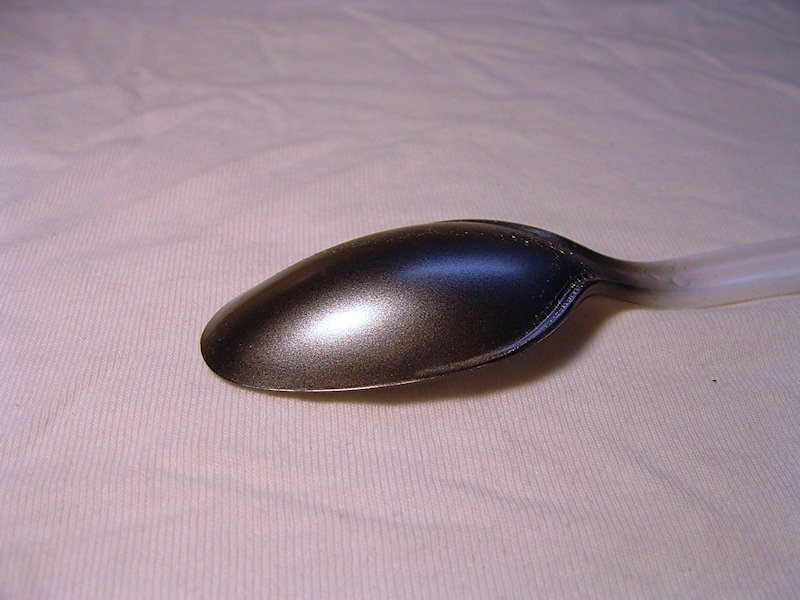

Well, I finally got some paint on a spoon. Not the best photos, but they get the point across, I think. Here's the FF paint over Alclad grey primer and Alclad black gloss base:
http://www.ipmsniagarafrontier.com/images/McLaren_FF_Chrome.JPG

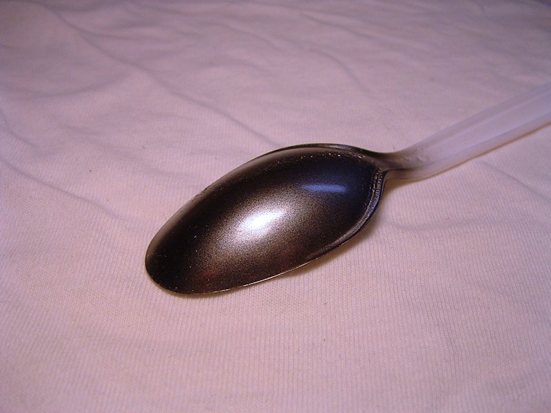

Here's the same spoon with a layer of Testor's Gloss Clear Lacquer on top:
http://www.ipmsniagarafrontier.com/images/McLaren_FF_Chrome_with_clear_coat.JPG

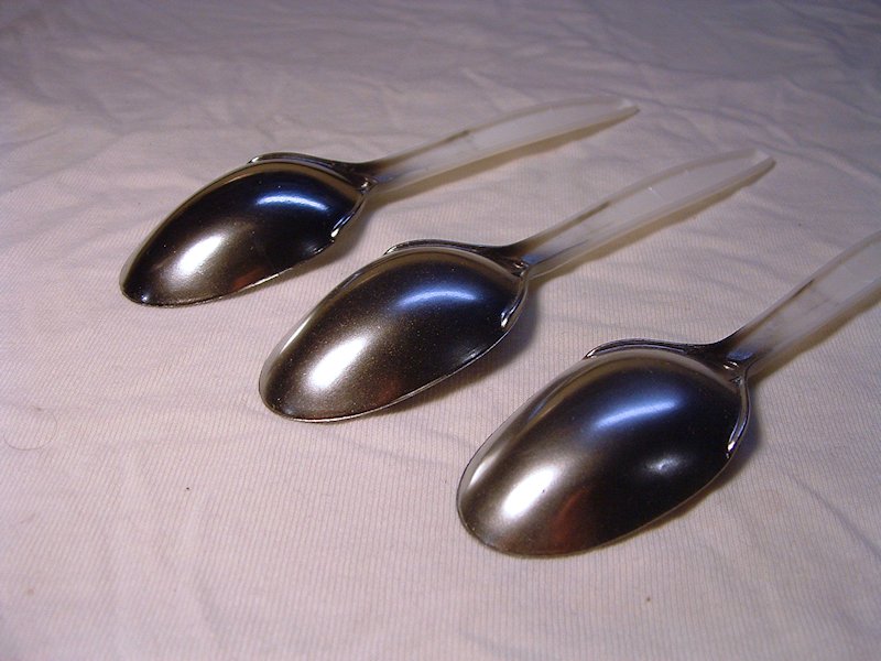

Finally, here's a shot of three spoons with Alclad grey primer and gloss black base as a base. The top spoon is Alclad chrome, the next one down is Alclad polished aluminum, and the bottom one is Alclad chrome with a layer of aqueous clear over it.
http://www.ipmsniagarafrontier.com/images/Alclad_chromes.JPG

The FF paint is nothing like Alclad. It dries with a semi-gloss or satin finish, and really looks more like a light gunmetal metallic rather than a chrome-like finish. It looks better with a clear coat over it. I might try it on my Revell 1/24th McLaren. I think I'll go with Alclad chrome with the aqueous clear over it for my Fujimi 1/20th McLaren.
