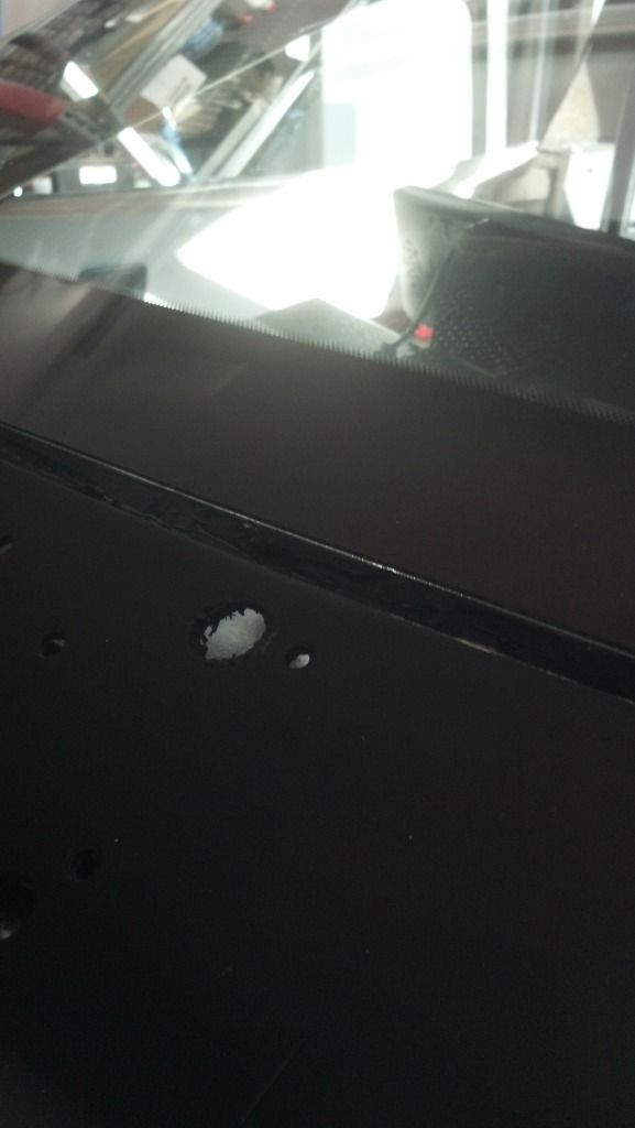

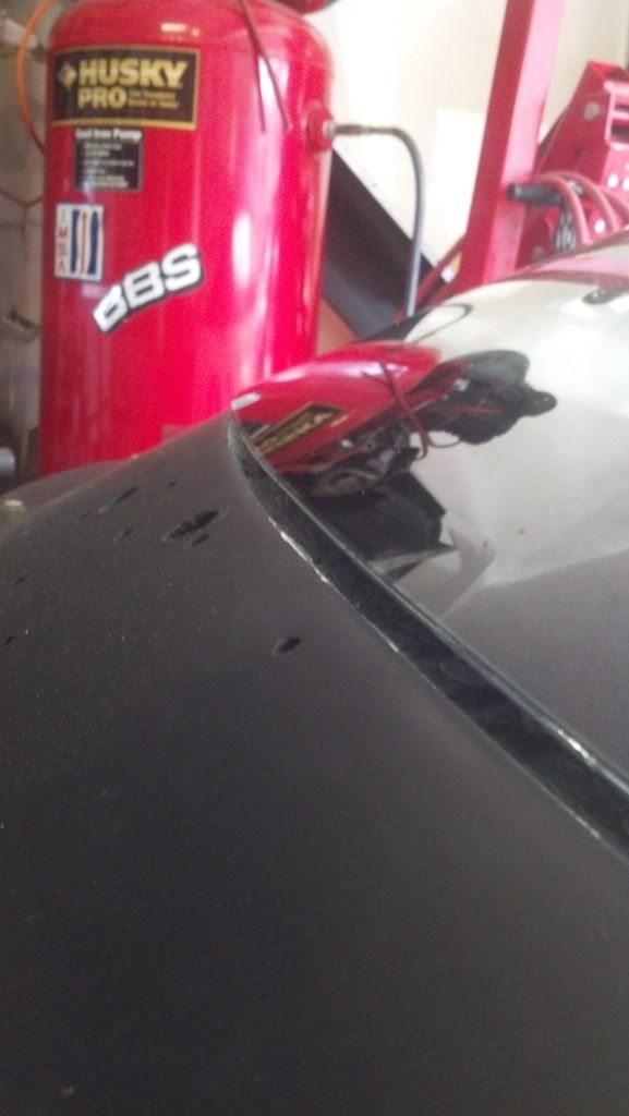

So I purchased a new (glass) windshield for the car. The first thing I noticed was that it wasn't going to go in with the rubber gasket/seal around it. I took the gasket/trim/seal off the glass and it barely fit on the top and sides, but it slipped in. Then I noticed the bottom. While the lower corners seem in place, there is a 3/4" to 1" gap between the middle/bottom of the glass and the body, as if the glass has a different contour on the bottom then the body/roof shell (Am I making any sense?)
When I got the car, the windshield was cracked. I pulled it, then removed the roof shell for painting and completely reinstalled it without the windshield. My first thoughts are I should loosen all the roof mounting bolts and see if I can reshape the lower mounting point (contour) for the windshield? If that doesn't work, build a brace between the dash panel and the lower windshieldsurface of the roof shell (Like I see on some of the GTS cars) and try to forcibly re-contour it?? Is there an easy fix that is escaping my limited experience with these cars?

Panoz60
12-14-2012, 06:19 PM
I dont know if the pics are better than my explanation, but here are two.
When I first got my car I cracked the screen on my first track day after sliding over some ripple strips. The resulting shower of shards of glass from the screen cracks quickly convinced me that lexan was a far safer option.
I had a local aircraft shop make me up 2 screens. 3 years later we are still on the same screen and we are running races up to 6 hours long pasing traffic all the time so lots of debris floating around.
I did fab up a chrome moly center support and 2 side supports for the screen. Only trick is to pick a thickness that will withstand the top speed of your local track. Otherwise would not look at glass for any reason.
Kel.
PS - I am sure the reason my glass screen cracked was due to pre loading due to poor fit. You may well be onto it regards unbuttoning the roof but you will need to be careful that you do not preload the screen when you zip everything back up again. Another trick is to make sure that no metal edges are touching the glass when it is installed as these will be hardpoints that will be crack initiation points.

Yeah, I think I'm going to use my new windshield (or as they say down under; screen :grinyes:) as a template and make one out of lexan. I stared at it for a while last night and fixing the contour of the roof shell would be major surgery. I'm sure what I spent on the windshield will not be the last money that will be wasted on a failed attempt. Anybody need a brand new windshield?
