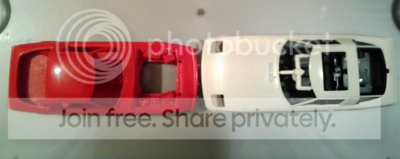

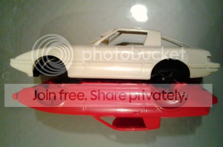

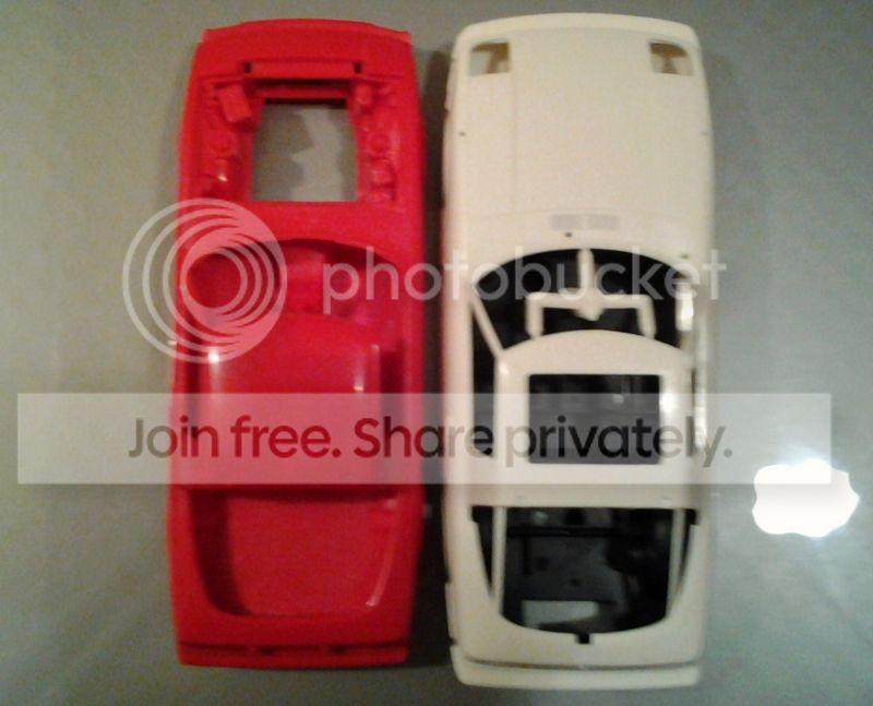

Hi guys,
I’m sorry for the slow progress, but.. .there is a reason for anything. And here is one.
As you know i have started with the Monogram kit (the red one)..i even made the fenders and some other parts… but the feeling there is something wrong with this kit did not left me since I opened it for the first time.:uhoh: This made me to look for one more kit of this car and finally found the Tamiya one, which is actually much more basic motorized curbside kit (facelift version which has right bumpers and tail-lights though).
It came today and guess what..- the Monogram is some kind smaller than it should be.:cwm27:. At the same time the chassis has the right wheel base and other elements look quite alright.:confused:
Indeed, once transformed it will not be that visible, because of the wide fenders but.. I will know it…
On the other side, at first glance Tamiya one looked some kind bigger than it should be, especially the front part..:uhoh:
There was only one way to find out the truth:evillol:
Today, I found a person that sells such car (the only one Rx7 1-st generation that is for sale here in Bulgaria) and asked him to measure the real car…and he agreed.
25 key elements of the real car were measured…he was really nice to do this
As a result I can say that none of them is 100% right...and I will use them both, taking the best from each one
Long explanation, but I wanted to share with you guys what bothered my mind. It is very exhausting to strive for excellence every time, but it is all for good I hope. Sorry for the bad pictures but It is 1 am already here and I am tired... Updates soon.
Vitan
http://i695.photobucket.com/albums/vv320/vitanvk/Rx-7%20Group%20B/25e4e27e-064f-4015-911f-b7fc6624ba84_zpsee2fb38a.jpg
http://i695.photobucket.com/albums/vv320/vitanvk/Rx-7%20Group%20B/ea238ba4-d9a4-483b-a801-002775ce5bbc_zps343e6451.jpg
Vitan
http://i695.photobucket.com/albums/vv320/vitanvk/Rx-7%20Group%20B/46e27b34-ac5f-4c8b-bfba-633964b90542_zpsa64ec112.jpg

Hi,
Yes.. it is hard with the dimensions, sometimes. Every kit has its own advantage or drawback, but it is always good to pursuit the best, when doing something...Can't wait to see details of the real "transformation" already..:lol2:
lovegt40
01-09-2013, 04:48 AM
typical of model kit cars.
The wheelbase seems identical on both models. Usually tamiya models are pretty in shape, but sometimes they are oversized.
I will not be so sure Monogram model is worng..cause is a monogram. Old american kits sometimes are way better than any japanese one of the past (I still remember the debacle around the F-4 phantoms. finally the most correct shape in 1/72 was the really old monogram models box, even if with ugly details..70s plane stuff u know).
With real measures can be better at all (I always use wheelbase as MAIN measure) then work on a lot and always keep an eyes to the pics to see if what u are doing is at least similar to the pics u can see with your eyes.
Or, take a good 3d designer friends and try one of the new 3dprinting service around. :D They are incredible....and suspect is the next generation of this kida masterworks.
If I am not wrong Michail or Roman from russia are also excellend 3d designers.. ;)
vitanvk
01-09-2013, 02:01 PM
Hi,
the wheel base is the same. This is the case, equal wheel base with differnet volumes..:) I didn't mean the Monogram is totally wrong, it is just smaller. Tamiya is a little oversized at the same time.. Actually if you look both kits separateley the Monogram one looks finer in some way..I think i can do quite good one, combining both:)
I totally agree with you about the 3D technology and i am definately willing to use it in future. It gives many possiblities, but you need good blueprints there too.
I suppose, then i will miss a bit all this sanding and reshaping by hand, looking at the pictures over and over again..i really love it.
Hi,

wow, that's a real noticable difference between the two kits. but it sure is a great thing that you managed to get the measurements of the real one (must've been fate :))

Wouldn't the Monogram one be 1/25 rather than the 1/24 of the Tamiya one (even if it says 1/24 on the box)? That said, these models are all rather old, so maybe the tooling wasn't ase accurate as nowadays. I have many RX-7 models, and all seem different...
However, for your project the Tamiya one is a beter choice, as it's a series 2/3 car (first generation RX7, 81 or 84 facelifted model). This means correct lights etc for the rally car you're building.
