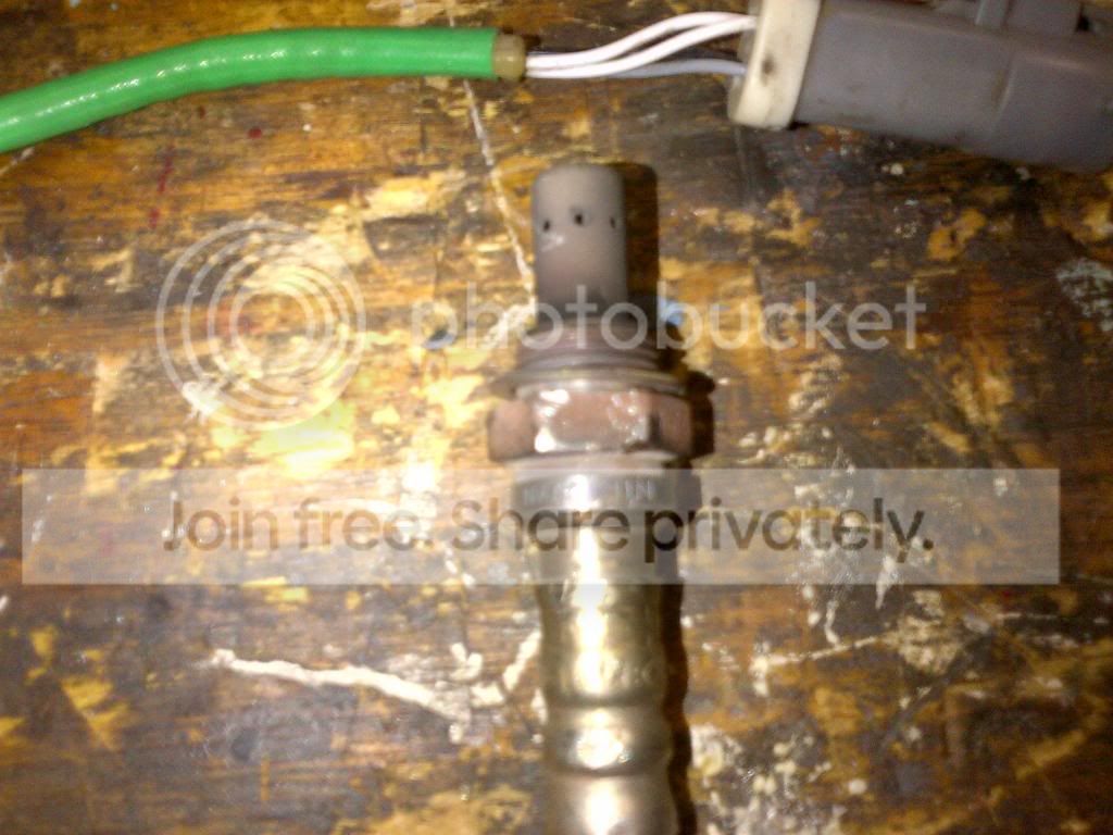

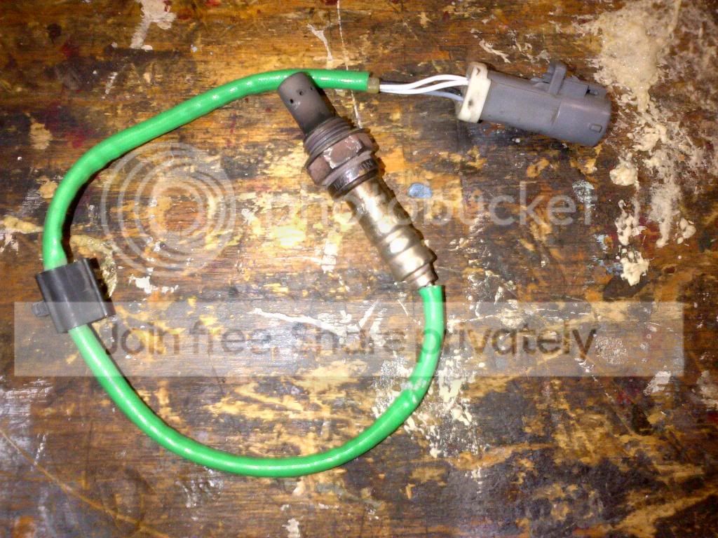

Well, here is the SOB that I couldn't get out..
http://i972.photobucket.com/albums/ae210/dborns/IMG-20121201-00004.jpg
http://i972.photobucket.com/albums/ae210/dborns/IMG-20121201-00006.jpg
My last attempt at doing this myself had me going to three different hardware stores looking for a stubby socket wrench. I couldn't find a shorter one in 3/8", so I bought a 6" crescent wrench that would fit a 7/8" nut. I tried it, but still didn't have enough room to turn it. There is a vertical support bar that runs up the middle of the car that gets in the way. Its only held in by a half dozen screws, and if removed would probably allow for a wrench to be turned, but the hood latch assembly is connected to it. You would have to remove the assembly to get that support out.
So while I'm feeling around to get the crescent wrench on the sensor, I noticed it felt loose. At first I thought it was just the top part of the sensor, but then noticed it was turning out! I must have actually got it loosened the last time I worked on it and didn't notice, or maybe with driving it as I have, the hot/ cold loosened it. With it being loose, thats probably why I got the check engine light because the wiring and sensor looked intact.
It was a little difficult getting the new one lined up but I found that if you get it started in the hole, and take a flashlight looking down from the top of the motor, you can just barely see it. I was then able to tell if I was inline with the bung and make adjustments to line it up. I couldn't get my arm down to it from the top, so get it started from the bottom then see if its lined up from the top and make adjustments from the bottom.
