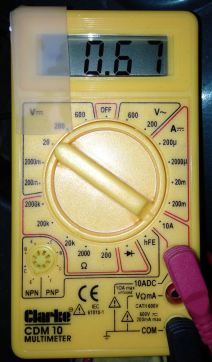

I've started with buying a new battery. I've also tested the alternator - it was giving almost 14 V when the engine was running - so it was ok.
Then I've connected the multimeter in series to the battery and it showed that something was taking about 0.67 A (sometimes 0.31 A) when the car was sitting.

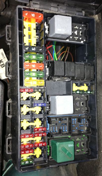

I started to pull out the fuses (the ones which I could myself) but it didn't helped at all - the value was still the same (0.67 A).

I've disconnected the alternator and the value changed to 0.01 A! I thought it has to be a faulty alternator then, so I bought a new one, connected it and now (while the car is sitting) it takes 0.07 A - it's a lot less than before, but I've read it's still to much. I've read that there shoudn't be more than 50 mA (0.05 A).
