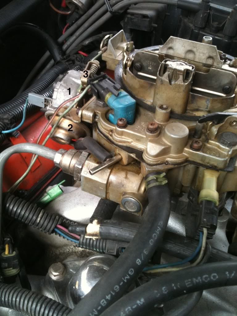

2dooreighty5
08-12-2012, 01:59 PM
http://i285.photobucket.com/albums/ll52/tohsiom2121/carb.jpg
so number 3 is the lever i was holding down
is number 2 or 3 the choke stove
silicon212
08-12-2012, 02:56 PM
#1 is the choke "stove". #2 and #3 are actually the same part, the choke pull off.
j cAT
08-12-2012, 05:51 PM
so if you where holding down the #3 lever this would be the choke pull off. so does the choke pull off have a leak ? when vac is applied it should snap back. when you disconnect the vac line to it push in that arm rod then place your finger over the hose hole it should stay in , take finger off hole and the come out.
looking at your set up I see a plastic T vac fitting. the rubber plug is with cracks so that must be replaced. avoid using those rubber vac end caps. they all crack. try to get a 90 deg instaed of the T fitting eliminating it .

2dooreighty5
08-29-2012, 12:20 AM
I replaced that t fitting so the pcv valve runs straight to the carb...
i also want to eliminate that charcoal filter which the other hose from the pcv runs to and there is two fittings coming off the carb one on the bottom right and one on the top middle as seen on the picture on the previous page...
when plugging these what would u reccomend besides rubber plugs?
silicon212
08-29-2012, 10:31 PM
Keep in mind that if you remove the charcoal filter, you will always have a gasoline smell from the car, most of the time a strong one.
