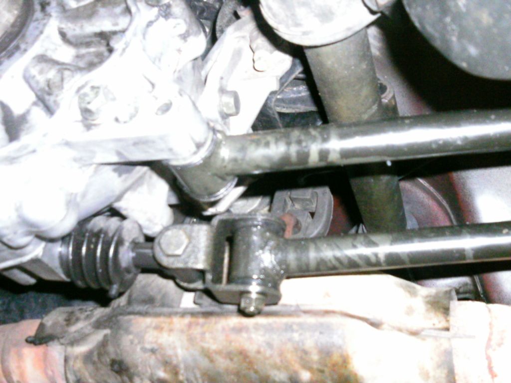

Follow up. I'm in the same situation, only mine is a 97 3/5 hatch.
What is involved in replacing the seal you mentioned? Can it be done with the transmission in the car?
http://i205.photobucket.com/albums/bb15/randallgenewilliams/Geo%20Metro/PTDC0033-1.jpg

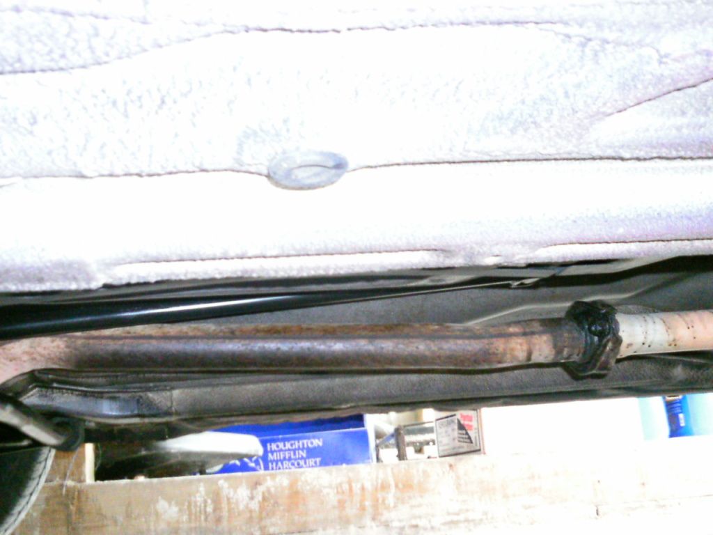

I'm leaking about a pint of good Pennzoil synchromesh from right there every 6 weeks, right onto the exhaust pipe (smelly.)
http://i205.photobucket.com/albums/bb15/randallgenewilliams/Geo%20Metro/PTDC0037-1.jpg
Crvett69
08-18-2012, 06:24 PM
if your sure thats where the leak is and not a axle seal you will need to take the tranmission out of the car. you can find a good write up on rebuilding the transmission by Dr Bill. if you read through that you will see what you need to take apart to get to seal

I haven't pulled the boot off yet to see exactly where the seal is leaking from, but I do think it probably would be from the center of the seal around the shaft and not around the outside perimeter of the seal. I'll pull the boot on Sunday and see where it is leaking from.
I'll post back what I find.
