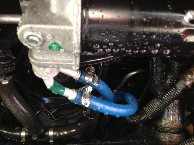

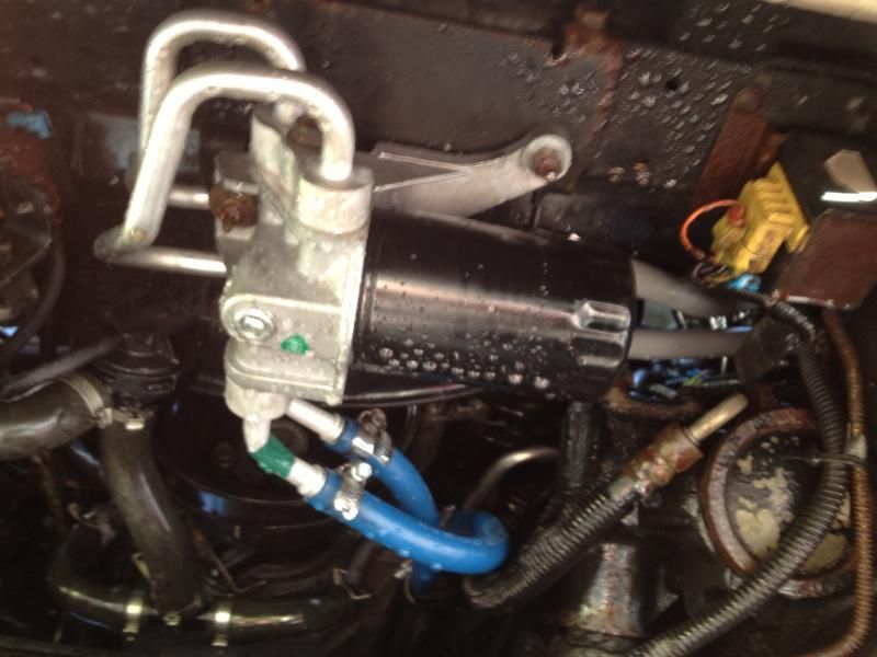

Replaced all 4 lines and the oil filter housing as all the bolt hols had broken
http://img.photobucket.com/albums/v448/therealsundance/IMG_12031_zps454bfc97.jpg
http://img.photobucket.com/albums/v448/therealsundance/IMG_12021_zps39887dcc.jpg
old_master
05-10-2013, 08:40 PM
Mighty risky using hose clamps. Cold oil pressure can reach 60psi or higher. If a line pops off at 70mph, it will empty the crankcase in a matter of a few seconds, and you won't know it until it's too late.
laxman21
05-11-2013, 10:40 AM
The guy at the hydraulic line shop said they would be no problem for 80 psi.
For 2 line like in your picture was $120. I pulled up this thread.
I did research it and followed this thread.
http://www.s10forum.com/forum/f107/repair-your-leaking-oil-cooler-lines-pics-fixed-343472/
Are you Captain Hook on Blazerforum?
