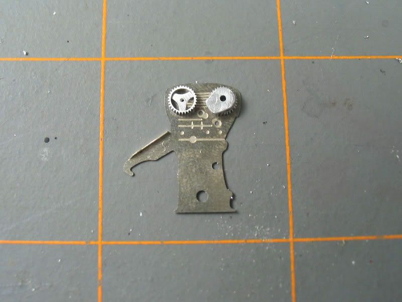

You wouldn't happen to know how the cam gears are to be assembled? I found the photo etch gears, 2 different options. But is there an included part to make the gear wider, similar to how the pulleys are assembled? I want to do the exposed timing belt setup :biggrin:

The cam wheels are something that Gio included for builders who were willing to do a bit of scratchbuilt detailing to their engines- so I'm not sure if cast wheels were included in the production editions. On my build, I've been planning to use my own machined parts-
http://i211.photobucket.com/albums/bb112/andrejmiller/camwheels.jpg
I cut the wheels out of aluminum tubing. You could probably do the same with a tubing cutter, or use plastic tubing of suitable diameter.
On the left side camshaft wheel (looks like the right side facing the engine), the camshaft position sensor needs to be built. Gio included a photoetched sandwich to build on the belt cover (parts 16-18). With the belt cover removed, you will need to build it onto the cam wheel.
http://img266.imageshack.us/img266/760/img0012la5.jpg
So you will really only need one open cam wheel.

Havn't worked on this for a while! But I've got most of the engine together now, just need to paint and wire it..
