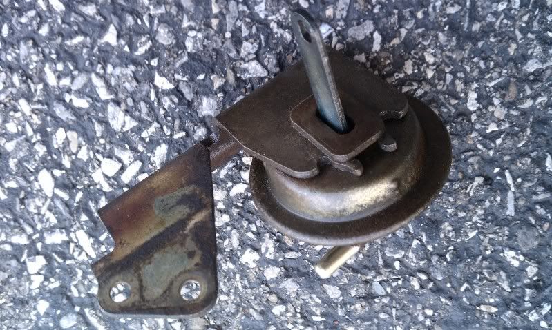

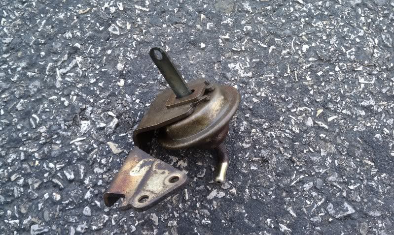

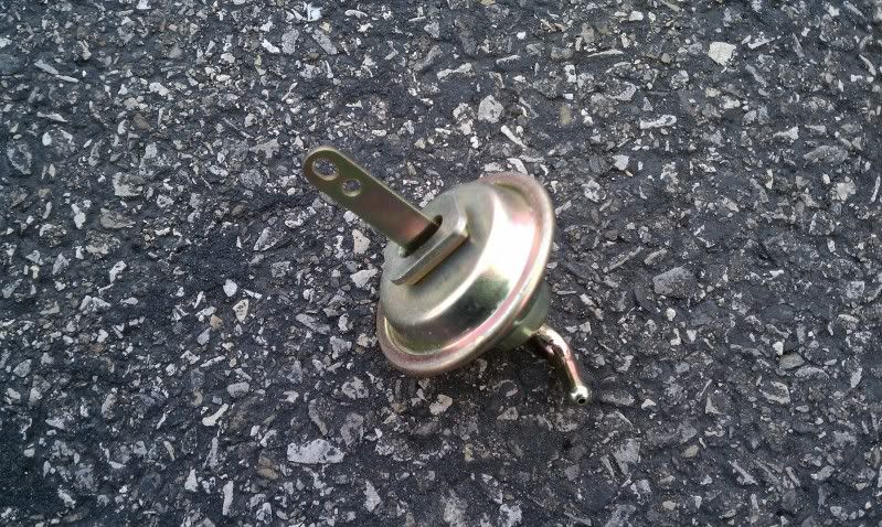

I'm trying to remove a choke pulloff from what appears to be a mounting bracket. I can't seem to get it off though. Any advice

Old
http://i63.photobucket.com/albums/h151/livewire1568/6%20Door/IMAG0006.jpg
http://i63.photobucket.com/albums/h151/livewire1568/6%20Door/IMAG0004.jpg
New
http://i63.photobucket.com/albums/h151/livewire1568/6%20Door/IMAG0005.jpg

Old
New
curtis73
03-16-2012, 09:52 PM
The bracket slides on and then those two tabs are crimped. You have to spread them and then it should slide off... although some were spot welded as well. If that's the case, just get one with the whole bracket.
curtis73
03-16-2012, 09:56 PM
Here... these two tabs. Spread them apart and it should slide off.
moliva1568
03-16-2012, 09:59 PM
Perfect. I was looking for a bracket with no luck so far. Finding the choke pulloff was a pain. I'll still look just in case I mess up the old one trying to open the tabs
moliva1568
03-16-2012, 10:44 PM
Mission accomplished. Thanks
