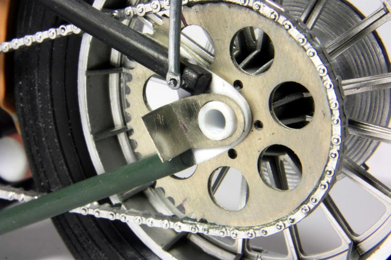

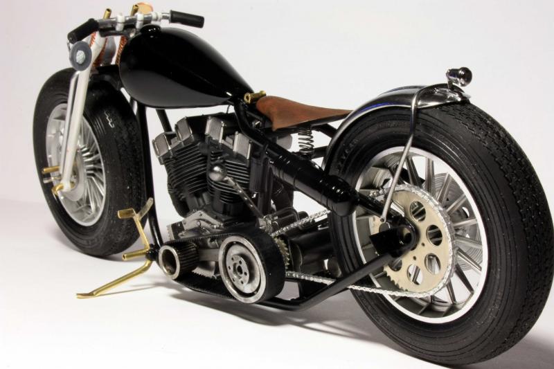

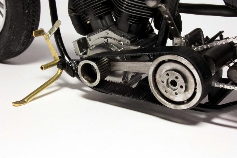

I scratched the primary belt using 3 layers of self-adhesive vinil for the body an 3 layers of vinil for the teeth

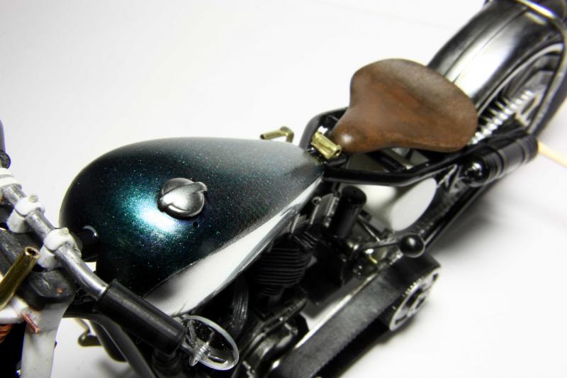

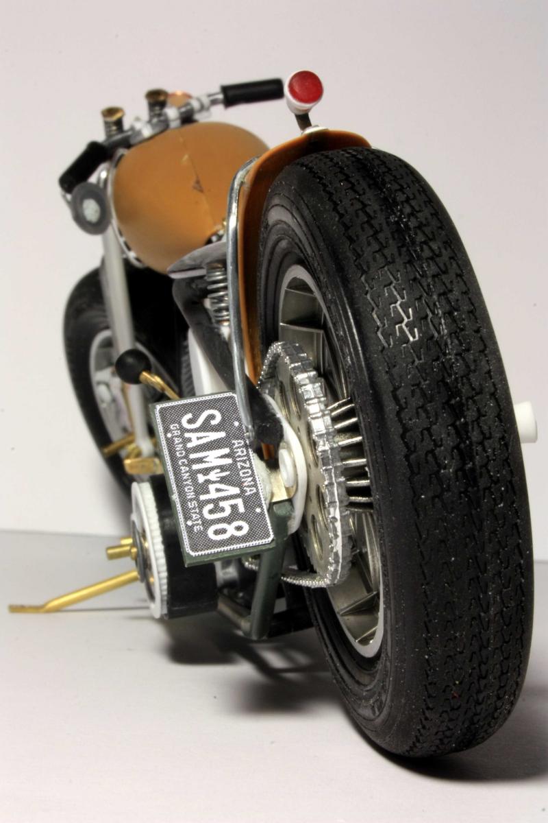

I built the oil tank, the fuel tank and the rear fender from scratch :naughty:

Ciao ketje! that vinil is simply the electrician's tape.. I stacked three layers of tape for the main body, I then stacked three other leaving a sticky surface and cutting off an infinite number of small teeth glued one by one on the body..:naughty:
A lot of patience is needed especially for the correct distance between them but the work pays off.. As the last thing I cut the tape to the right width (7mm) and I brushed a drop of glue on the sides to make sure that the teeth were not moving on the body..

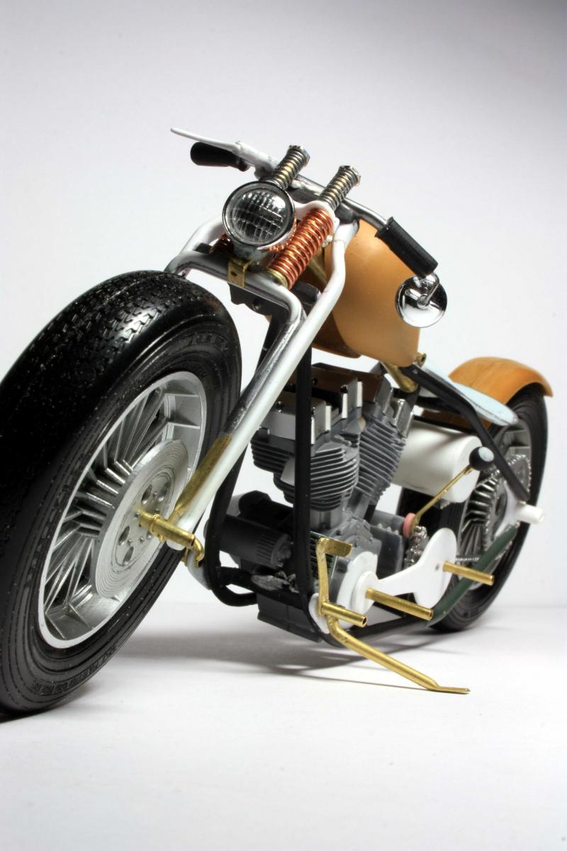

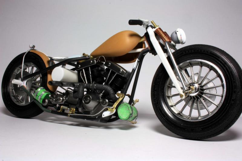

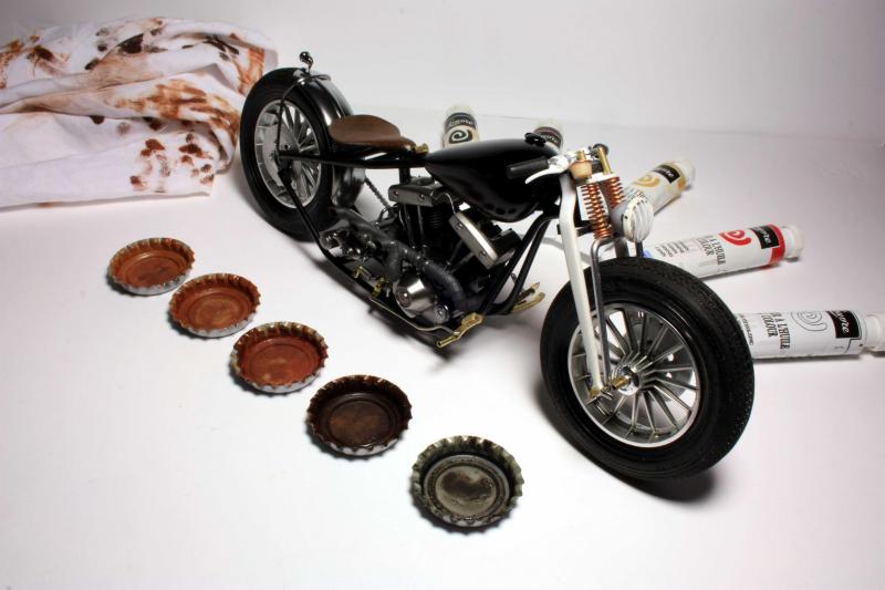

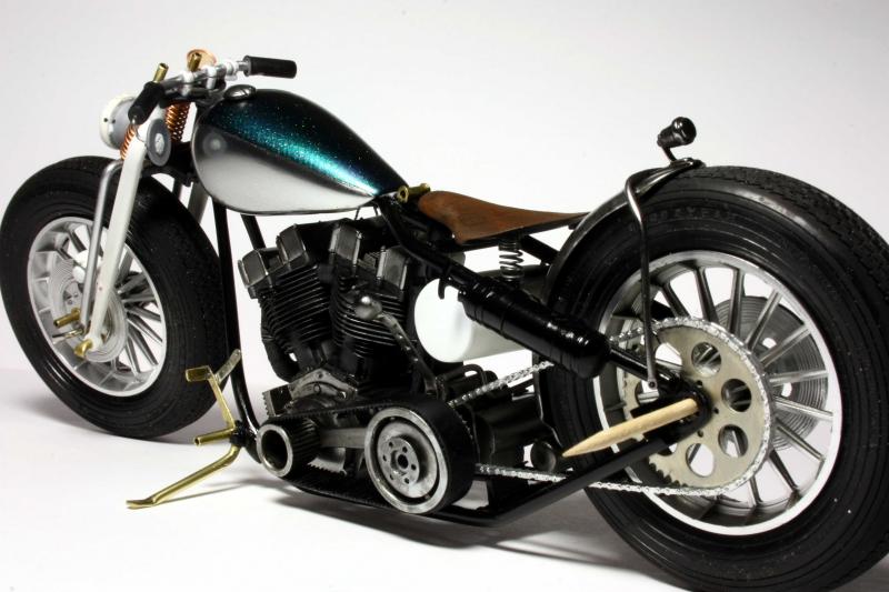

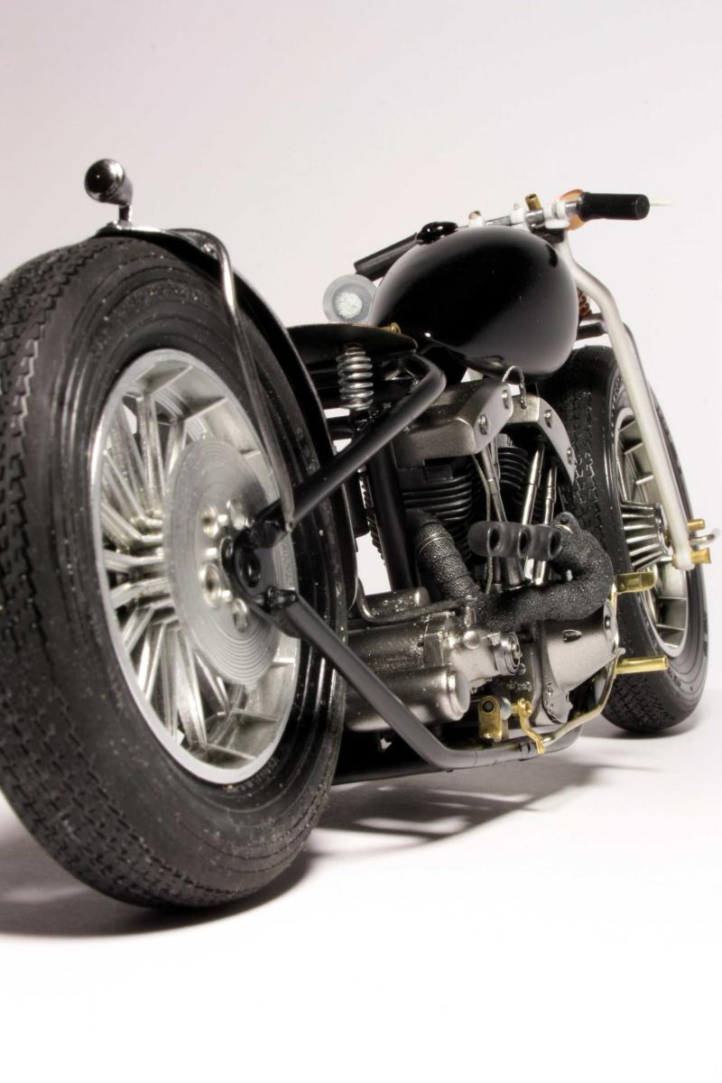

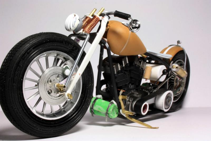

I modified the frame giving it the typical gooseneck frame shape..

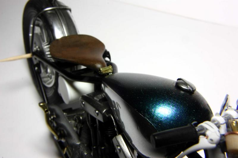

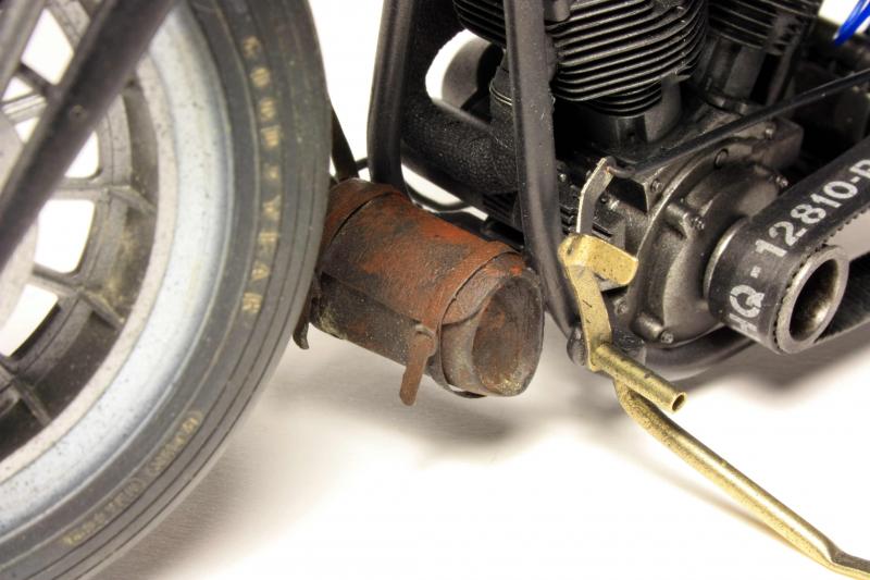

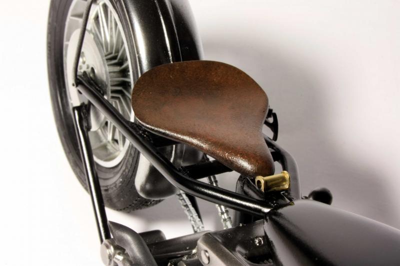

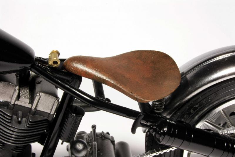

Today I scratched the seat and the exhaust using aluminium, steel and plasticard..

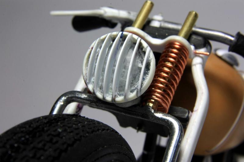

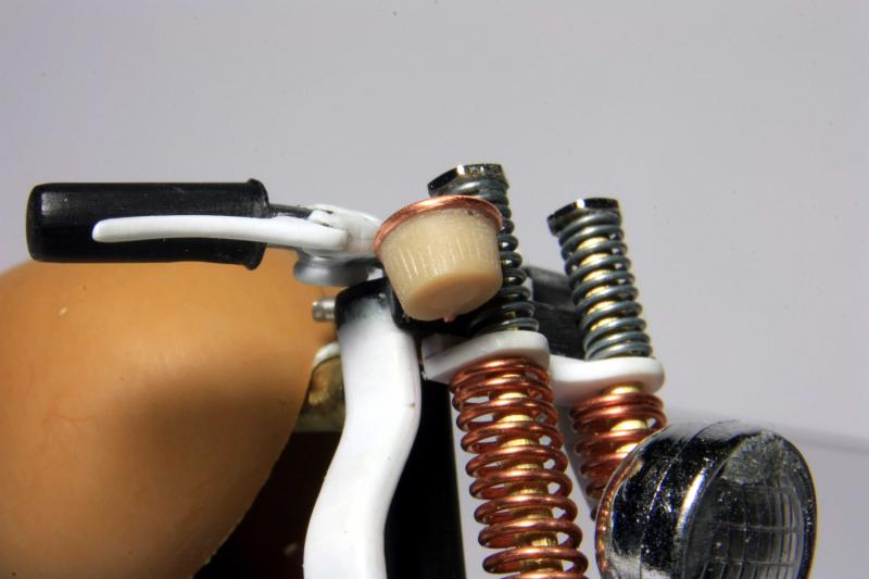

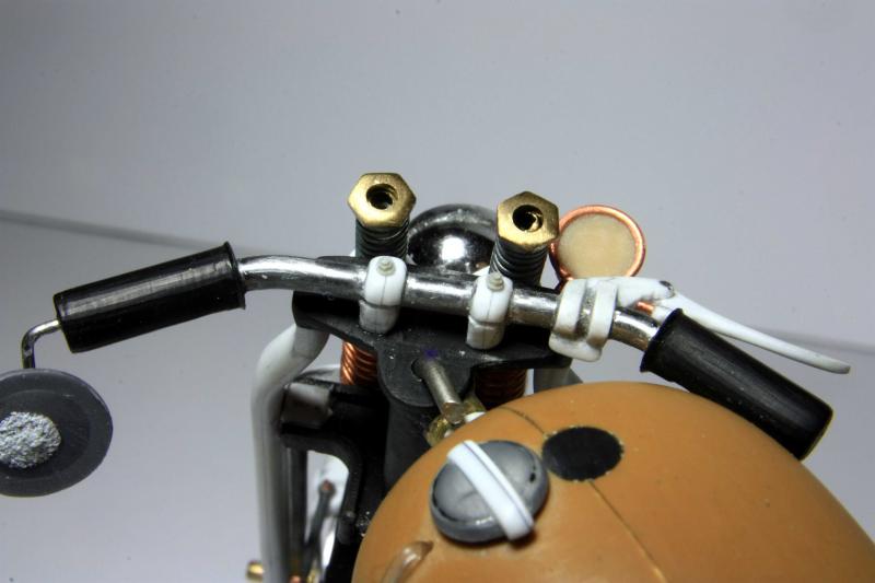

Springer front forks.. they are totally scratchbuilt using plasticard and a 2mm tube of brass.

Some progress on the forks..

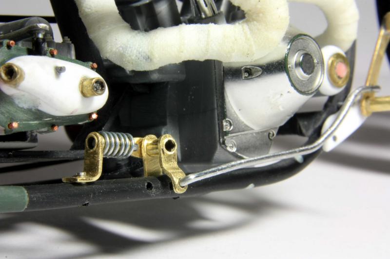

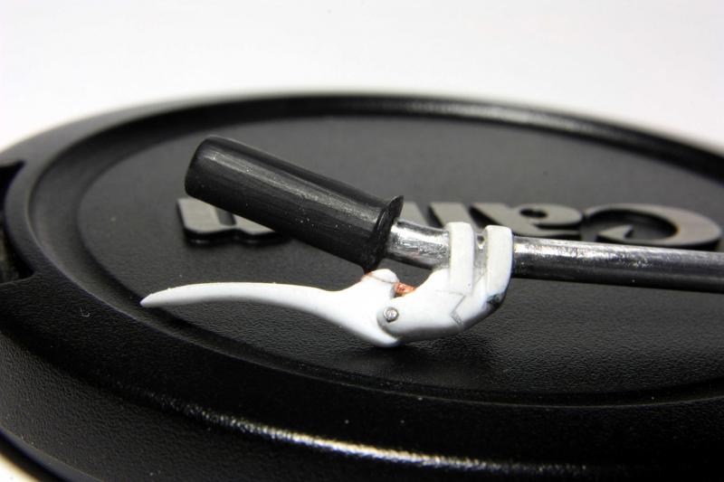

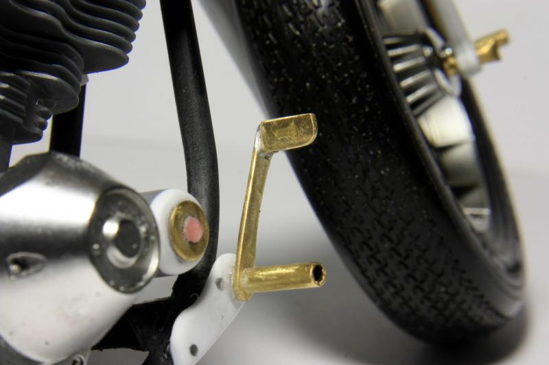

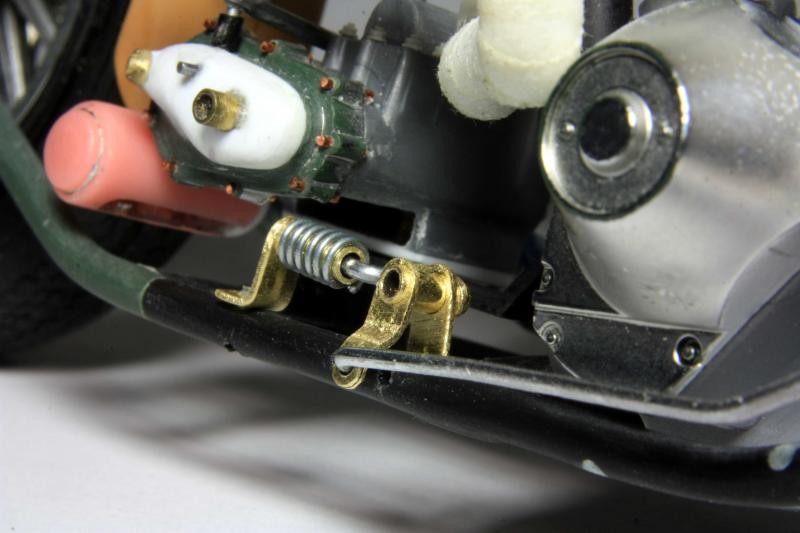

I modified the springs and I scratched the kickstarter..

I scratched exhaust using plasticard, brass and 2k putty.
It must already be well-finished..

waiting for good weather to start painting I built the rear brake lever.
They then started with a paper clip and a few tubes of brass to get an E-link system connected to the piston of the disc brake.
http://www.modellismo.net/forum/attachments/statico-work-progress/137390d1333637688-harley-samurai-chopper-img_9871.jpg
http://www.modellismo.net/forum/attachments/statico-work-progress/137392d1333637766-harley-samurai-chopper-img_9874.jpg
http://www.modellismo.net/forum/attachments/statico-work-progress/137393d1333637808-harley-samurai-chopper-img_9877.jpg
http://www.modellismo.net/forum/attachments/statico-work-progress/137394d1333637841-harley-samurai-chopper-img_9875.jpg

At last I modified springer forks, rebuilding the springs-support and scratching a neww front-light.

Finally begun to paint .. I started the engine last week and continued with the chassis and the superstructure. I started with a basic uniform glossy black, then sprayed with clear gloss (protecting parts in polished brass with tape). So I painted with Alclad chrome rear fender and I finally made a special treatment with oil paints to simulate "vintage" leather.
http://www.modellismo.net/forum/attachments/statico-work-progress/139463d1335683084-moto-harley-samurai-chopper-img_9989.jpg
http://www.modellismo.net/forum/attachments/statico-work-progress/139464d1335683126-moto-harley-samurai-chopper-img_9992.jpg
http://www.modellismo.net/forum/attachments/statico-work-progress/139465d1335683154-moto-harley-samurai-chopper-img_9994.jpg
http://www.modellismo.net/forum/attachments/statico-work-progress/139466d1335683178-moto-harley-samurai-chopper-img_9997.jpg
http://www.modellismo.net/forum/attachments/statico-work-progress/139467d1335683199-moto-harley-samurai-chopper-img_9998.jpg
http://www.modellismo.net/forum/attachments/statico-work-progress/139468d1335683229-moto-harley-samurai-chopper-img_10003.jpg
http://www.modellismo.net/forum/attachments/statico-work-progress/139469d1335683264-moto-harley-samurai-chopper-img_10004.jpg
http://www.modellismo.net/forum/attachments/statico-work-progress/139470d1335683290-moto-harley-samurai-chopper-img_10006.jpg
http://www.modellismo.net/forum/attachments/statico-work-progress/139471d1335683339-moto-harley-samurai-chopper-img_9991.jpg
HIPPIE2
05-05-2012, 10:00 AM
The paint is great, but wow those welds are brilliant idea i hope you don't mind me copying

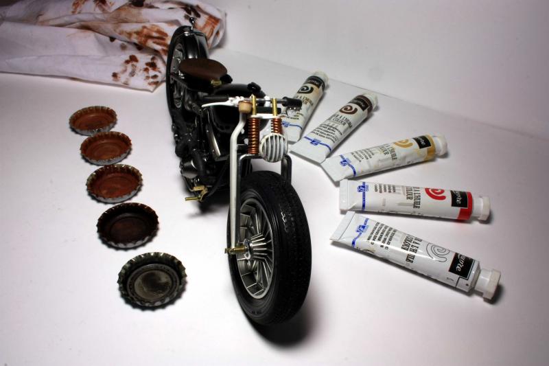

Color Color Color..
