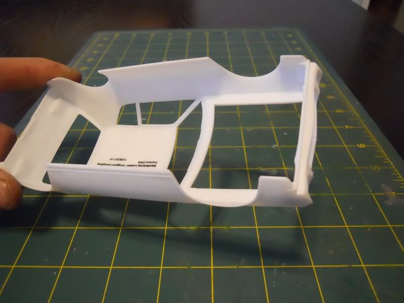

The first thing I did was thin the wheel arches. You probably can't tell in the photo, unfortunately. I started doing this on model imports so the wheels can sit a little flusher (I'm not all hellaflush but I do think that the closer it is, the better it tends to look), but it's kinda become standard for everything. It's kind of how bigger wheels and lower suspension looks better on a model than being exactly right, thinner wheel arches do, too.

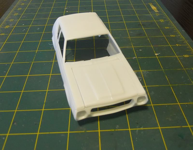

I also opened the front grill area (more on that later) before gluing on the front facia. The hood fits properly when you pull the body out of the box, but when you glue the facia on you end up pushing the fenders further apart, and there is a really ugly gap toward the front of the hood that needs to be filled.

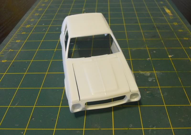

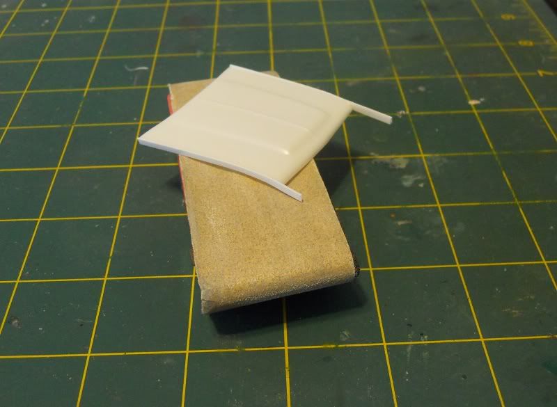

Not a new trick by any means, I know it's been documented here plenty. I glued a strip of plastic down each side of the hood, and trimmed them to almost length. Then I sanded the sides of the hood until it fit. You definitely need some sort of a sanding block to do this! I was lucky, the plastic strip I added was just the right thickness so I just had to sand the rear edge completely away and leave it full thickness at the front; a good guideline.
http://img.photobucket.com/albums/v417/willimo/Gremlin04.jpg
Much mo betta. I realize that the hood is now probably wider at the front than the rear, and to avoid that I could have used any number of other techniques but this was fastest. So about that opened grill area...

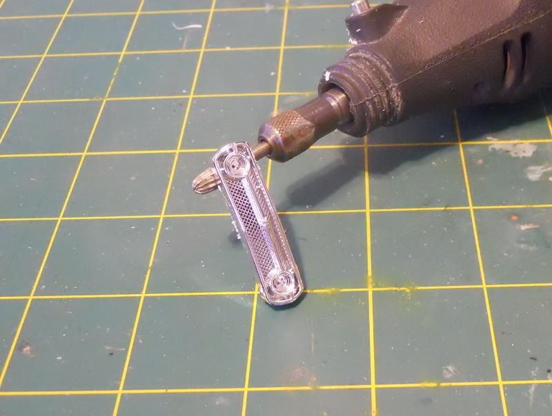

I intend to remove almost all the chrome on this car so there was nothing marrying me to the grill as AMT molded it (though, looking at that picture, it looks really good!). So, like I did on my '69 Camaro, I used this grinding bit to remove a lot of material from the back of the chrome grill. The Dremel tends to be a big hammer for a small problem so I just ground it until I got close.
http://img.photobucket.com/albums/v417/willimo/Gremlin06.jpg
This picture is probably worthless, but the idea is that you can just start to see the chrome plating from the backside of the plastic, meaning I'm close, time to file from here! No pics yet, but I finished most of the cleaning before dunking the chrome grill and bumpers in a bleach solution to remove the chrome entirely. I will have pics once it's cleaned up and ready for paint.

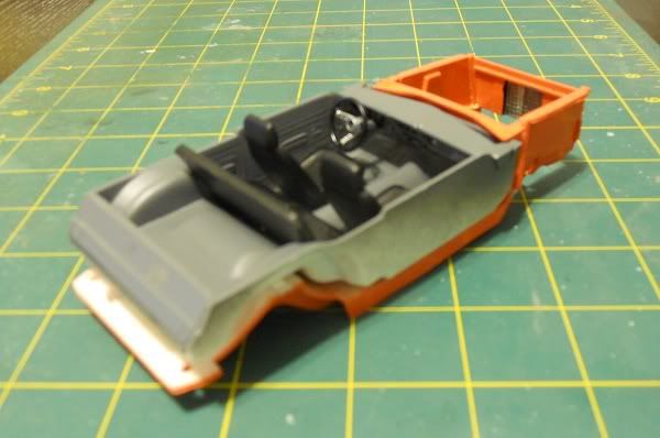

So, I didn't make my one week goal. At all. Here I am much later still working on this thing. I'm kind of building this out of my typical order, so you'll notice the body is all incomplete, no lights or grill or trim or anything. I did get most of the chassis, engine, and body area done and the interior completed enough. Sorry for some blurry pictures coming:

Seats are out of a '69 Camaro. The kit ones looked a little narrow but close and fairly accurate but... augh, what the heck! Where seats like this in the '70s? Really? Anyway, I think these look better any my color scheme is just made up to look good; just for visual interest. If I can't really make a good looking Levi's denim interior, what's the point of trying to be accurate? I also added a huge sewing pin as a shift lever because there was none in the kit.

The body is glued to the chassis and interior bucket and the chassis glued down. The chassis was a little warped and drooped in the back. Mocking it up showed that the rear edge of the chassis showed below the bumper. I had to carefully but firmly bend it to fit properly, and then permanently attached it to the interior bucket to keep it straight. Clearly the engine isn't done, nor is the body, but this is as far along as it got today....
The grill fits terribly in the front facia. It's way to small... like 1/28 or something. I will have to add plastic like I did to the front of the hood. I also foolishly dechromed the bumpers. The are so blocky and miserable I thought I could improve them, but now they don't even have chrome on them so they're a double fail. Oh well, I'll have to fix that.
Almost done anyway! Comments and criticisms are great.
