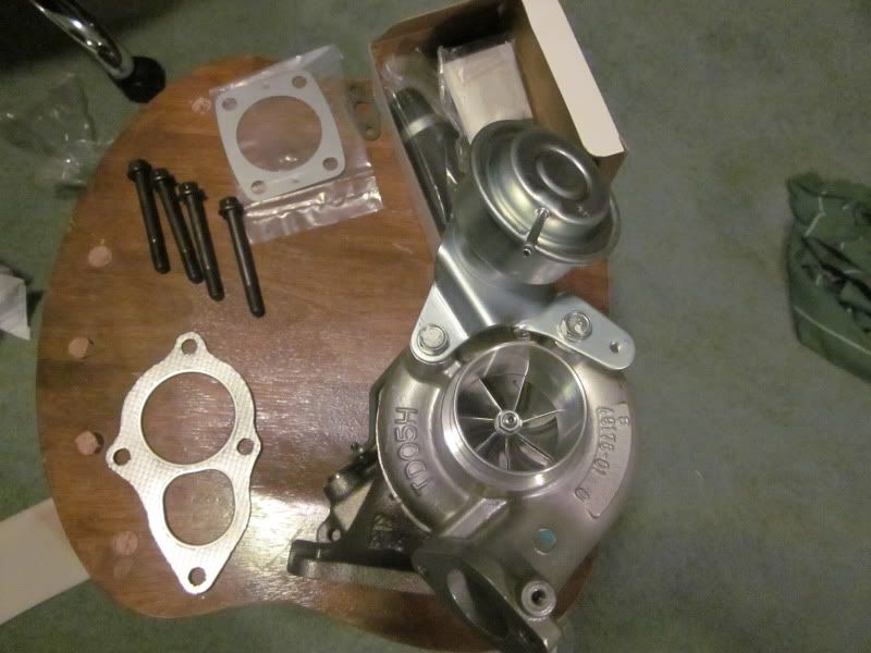

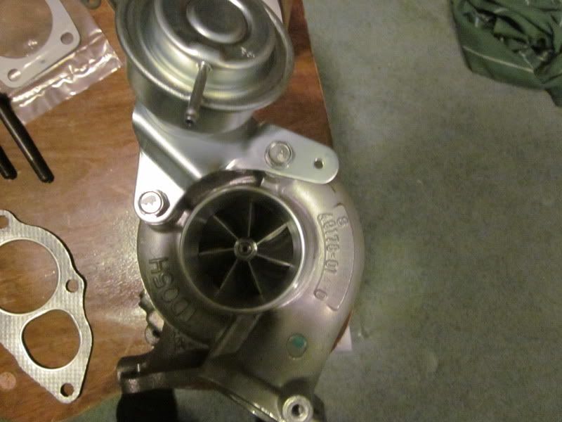

I finally got my Turbo from Forced Performance today. I didn't really have a lot of time to look at it because I was on my way out the door when UPS came.
Anyways everything was there I will have some pics of the turbo and parts up tonight I think.
I figured for this thread I will try and get some logs and screen shots and give you guys a comparison with my existing FP 18g so you can see for yourselves what if any improvements to power/spool etc it makes.
I'll also try and document my install as well.

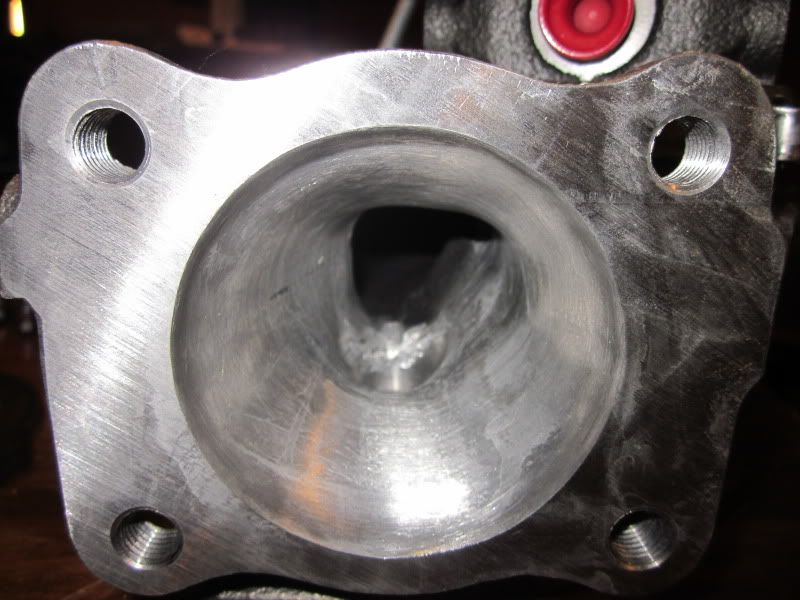

Yea that porting is top notch! I want to do this weekend as long as I don't get sidetracked I should be sweet. BUt never know. It won't take as long as Brian.

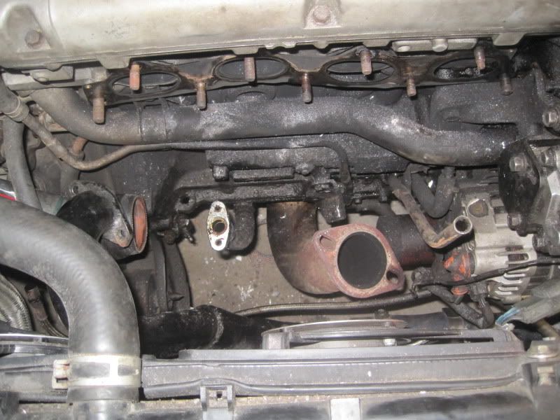

http://i83.photobucket.com/albums/j294/steviekallday/552.jpg

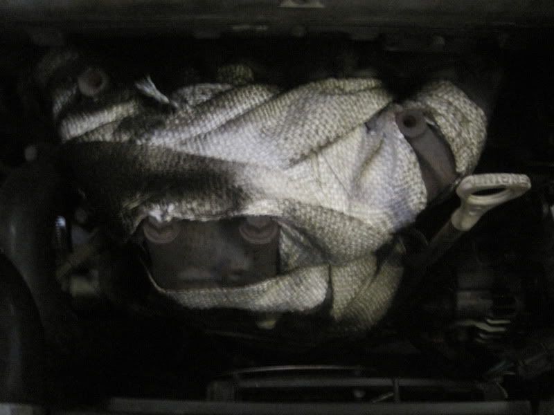

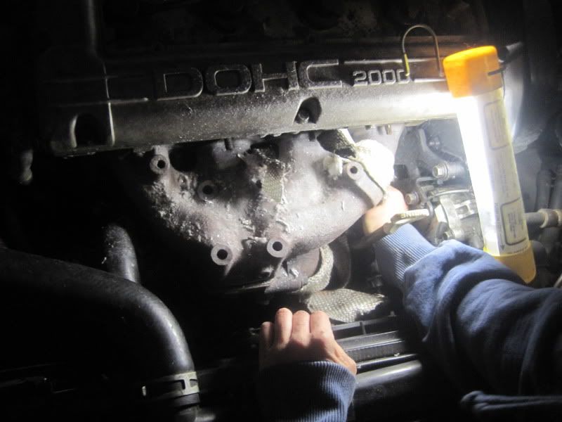

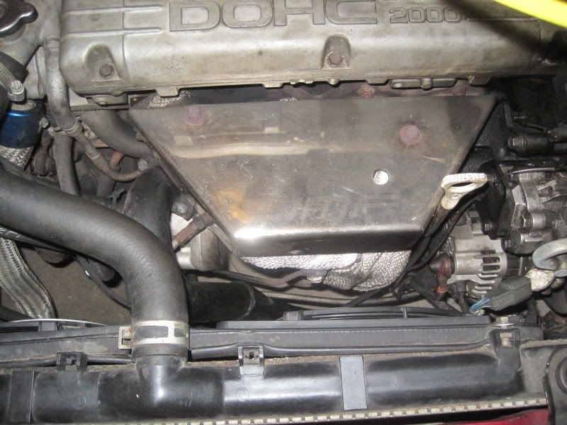

First and by far the hardest thing to do was take off the JMF heat shield.
http://i83.photobucket.com/albums/j294/steviekallday/553.jpg

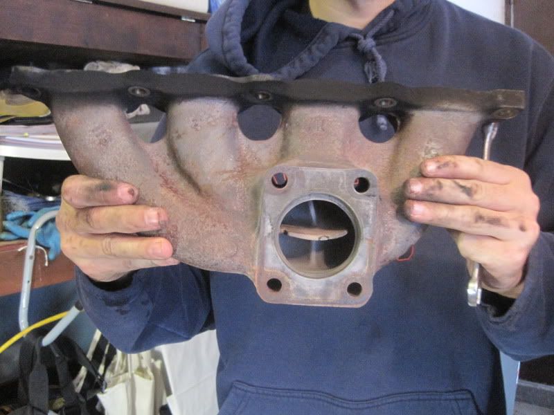

So that went off nice and easy and then time to do the manifold.
If I had hindsight I would have undone the Down Pipe first before I took off the Mani.

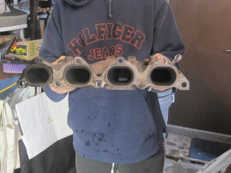

http://i83.photobucket.com/albums/j294/steviekallday/554.jpg
http://i83.photobucket.com/albums/j294/steviekallday/555.jpg
http://i83.photobucket.com/albums/j294/steviekallday/556.jpg
http://i83.photobucket.com/albums/j294/steviekallday/557.jpg

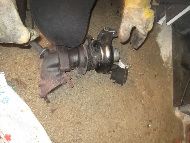

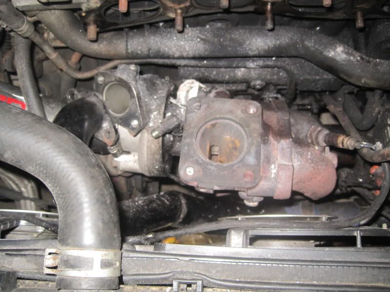

The DP was hard to get off because its soo ackward but after that we got the oil lines off and the intake came off no problem so we were able to break the turbo free with the o2.
http://i83.photobucket.com/albums/j294/steviekallday/562.jpg
http://i83.photobucket.com/albums/j294/steviekallday/561.jpg

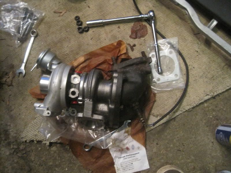

Then it was time to get the o2 off it.
http://i83.photobucket.com/albums/j294/steviekallday/564.jpg

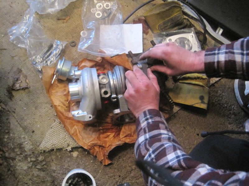

THen I put the new gasket and a new stud into the turbo and bolted up the o2.
http://i83.photobucket.com/albums/j294/steviekallday/565.jpg

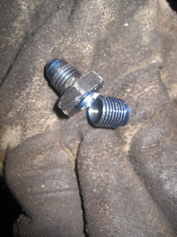

Then it was time to put the oil feed line on the turbo.
Here is where shit got fucked up. I torqued the 12mm * 1.25 to-4an feed adapter just a little too much and well pic says it all.
http://i83.photobucket.com/albums/j294/steviekallday/566.jpg
Now I'm stuck. Don't know anywhere in canada that carries AN fittings. Only americans use it haha! So i can either order one and wait a week :( or well I don't know just try and find one around? anyone know a loaction in canada that might have one?
The hardest part is done the reinstall will be much easier its just a pain in the ass now. And obviously might not have my friends help next time.

That royally sucks man. Have you googled locations in Canada that may carry them? Any racing shops in a 100 mile radius?

Summit Racing FTW! Always gotten my items from them next day, even with standard shipping. Great for when breaking fittings. Done that plenty of times.
steviek
12-29-2011, 11:15 AM
I ordered from summit racing. The 15 dollar part costs me 35 with shipping and lets not forget the down time.

That really sucks dude, at least its an easily replaceable part. And on the plus side you where able to get the broken part out the turbo. Cant wait to see what this thing can do. I have seen a few cars on tuners running some impressive times on this thing.
