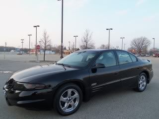

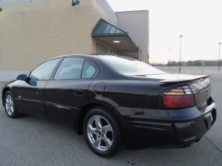

Thanks tech for your post,it's at a dealer haven't looked at it yet from the pics it's very clean no issues with it he says but I'll be the judge of that when i give it the once over,yes loaded right up, all electronics work just wondering how solid the trans and the sc'd 3800's were I've owned many N/A 3800 and they've been bullet proof.
new tires and breaks with 119,000 miles he said he'd take $5,000 out the door which is a real bargain.
