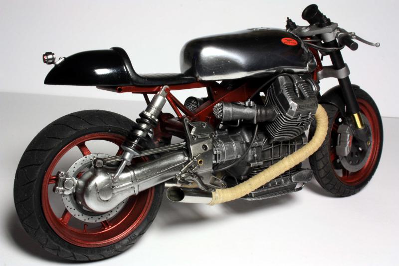

An Italian forum started the "Café Racer Bikes Contest" and this is my project based on the Tamiya Guzzi Centauro..
I saw a lot of wip about this bike, so I'll try doing something different..
I started the model removing the rear swingarm and I've scratched a new one using plasticard and the original hub.
I also cut the fuel tank in the half and I have rebuilt the rear missing part using the tail of an old Honda NSR500.
After that i've modified a rear wheel of the same Honda adapting it to the single arm:grinyes:

These days I scratched the rear mono-shock using the original spring, plasticard,brass, steel and a little copper wire.
I've chose a particular configuration of the rear shock, linked between the swingarm and the frame.
Then I mounted front forks, wheel and handlebars from Honda NSR500

So I scratched the tail using 10 layers of 1mm thick plasticard.

I scratchbuilt the Exhaust system using brass, aluminium and plasticard..:licka:

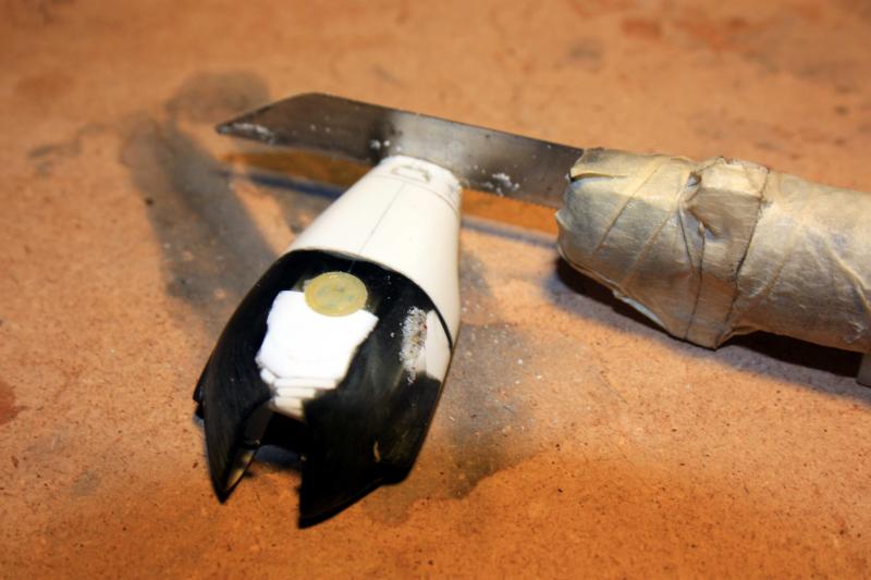

But the gas tank was too long.. so I cutted it off

So I glued, filled, filed, sanded and mounted it

I detailed the engine with a lot of thin copper wire.
I scratched a new steering ammo and a new stand using brass, plasticard and steel.
I also modified the light support making it more similar to the real one

Coinciding with the end of the contest I finally finished the guzzi .. do not miss anything, is ready to be exhibited in the showcase.
http://www.modellismo.net/forum/attachments/contest-moto-cafe-racer/139456d1335681978-cafe-racer-guzzi-special-img_9978.jpg
