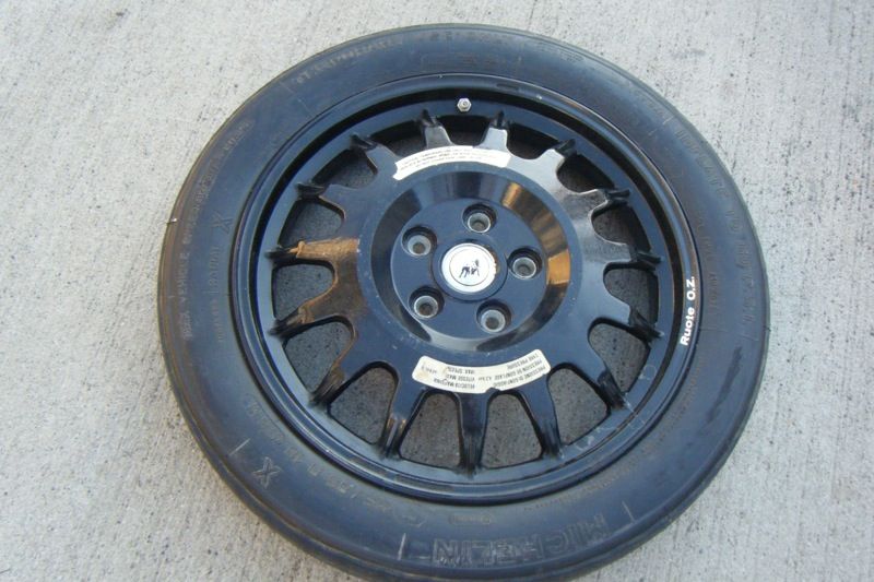

Does anyone have or know where I might find a 1/12 wheel &tire that looks similar to this?
http://ferraris-online.com/cars/LA-LP5000-12101/images/P021Web.jpg
http://www.lambopower.com/forum/uploads/monthly_12_2009/post-4314-1260224316.jpg
