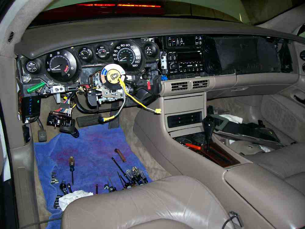

Been there. You'll have to dig into the dash,
http://www.wwdsltd.com/files/RivieraDashDisassembled.jpg

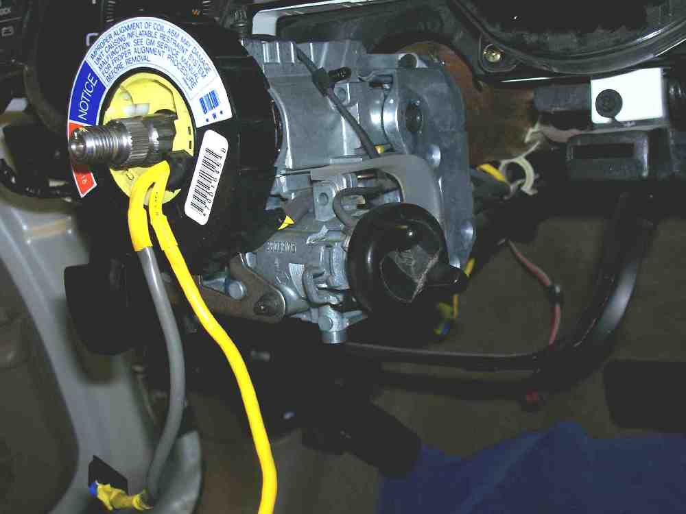

Remove the upper column housing:
http://www.wwdsltd.com/files/RivieraTiltMechRH.jpg

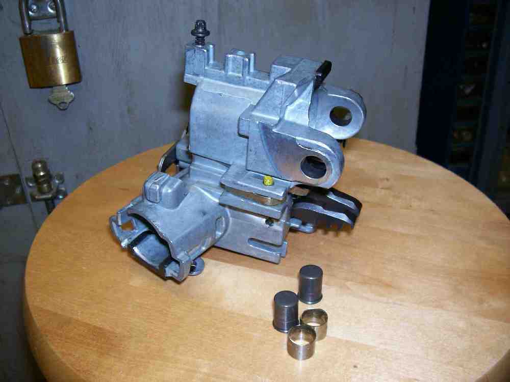

Manufacture some bushings:
http://www.wwdsltd.com/files/RivieraPivotPinBushings.jpg
Press them in place and reassemble:
http://www.wwdsltd.com/files/RivieraPivotPinsBushed.jpg
There are few options on this type steering column.
