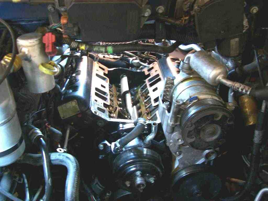

As you can see, it is possible without disturbing the AC line set:
http://www.wwdsltd.com/files/262IntakeTeardown.jpg
This 2000 has dual air, BTW. The compressor has to be lifted from the mount and moved slightly out of the way, but the AC system does not necessarily have to be recovered and evacuated.
It's about an eight hour job if everything is clean and organized. Look closely at the intake flanges for the telltale contact patterns of the intake flange gaskets.
