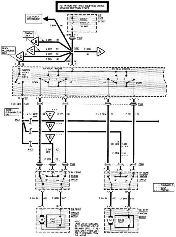

The only relay in the power window sytem is in the express down module. All of the other door windows get power from the master switch, through each door's individual switch and directly to each motor. If you use express down and the relay sticks it will cause the cicuit breaker to open rendering all other windows inop. Be careful, but you can touch the power window circuit breaker and if it is hot, I would recommend unplugging the express down module. (You will have to remove the door panel) The driver window will not work, but if it is part of the problem the other windows should work. Schematics below:
http://i36.photobucket.com/albums/e50/twabelljr/Windows1.gif
http://i36.photobucket.com/albums/e50/twabelljr/Windows2.gif

A break in the brn wire to C1 on the switch plate where the door flexes it opening and closing would cause loss of power to all windows as I read it. Pull it switch plate and check for power at C1 while moving the wires in the door tube, e.g.
Also the ground at C200 could be the problem. Does anything else inside the car not work right when the power windows don't work? Lots of things use the C200 ground on the driver's door sill area. Those can be corroded..
