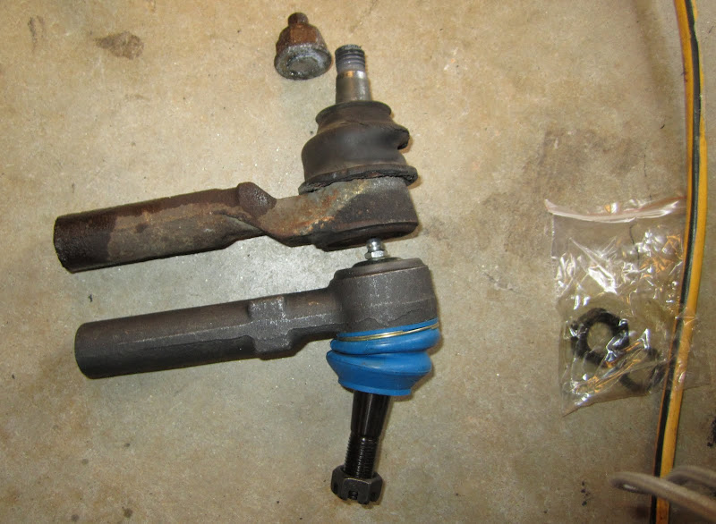

JLARSJ
07-31-2011, 11:28 PM
Hoov,
I've read your posts around for a long time..always helpful as I've tinkered with my ride.
So, my tip to you today, if not too late, that is.... if the old nut doesn't come off, sawzall it off. Like below.
Also, see my nuts :icon16: .... new ones have been on for 6 months with no probs.
Btw, I measured the center of the new ball joint to the end with the old and new, same dimensions.
Good luck with it!
https://lh5.googleusercontent.com/-fS8dcrla8HQ/TY-KmHdp4PI/AAAAAAAAd-g/09C5j7zYJHU/s800/IMG_2670.JPG
