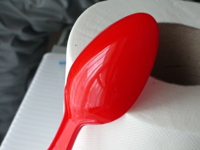

Just as a hint. These are plastic test spoons, primed and painted TS-49 Bright Red. Straight from the can with no polishing whatsoever. The reflection is the net curtain at the window. This is where I would be at before I go to the compounds. Just saves a lot of compounding if you get the paint application as good as can be from the can...

Nice gloss on the spoon Steve
