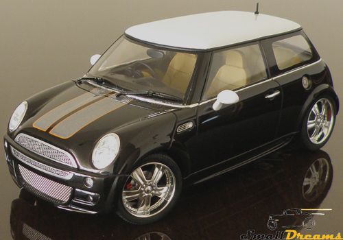

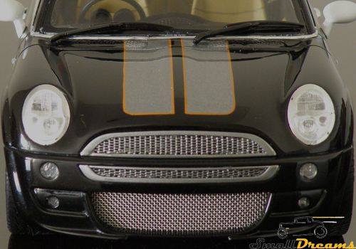

Finished job
http://i122.photobucket.com/albums/o278/bossolani/mini/mini_40.jpg
http://i122.photobucket.com/albums/o278/bossolani/mini/mini_45.jpg
It was prized award theme on IPMS-Campinas contest in 2009... It's a curbside between a lot of models with engine...
http://www.grupogpc.com.br/hobby/plastimodelismo/campinas/xivat.html
Nice words bro!!! I apreciate that!! Thanks !!

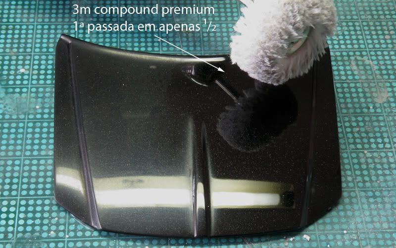

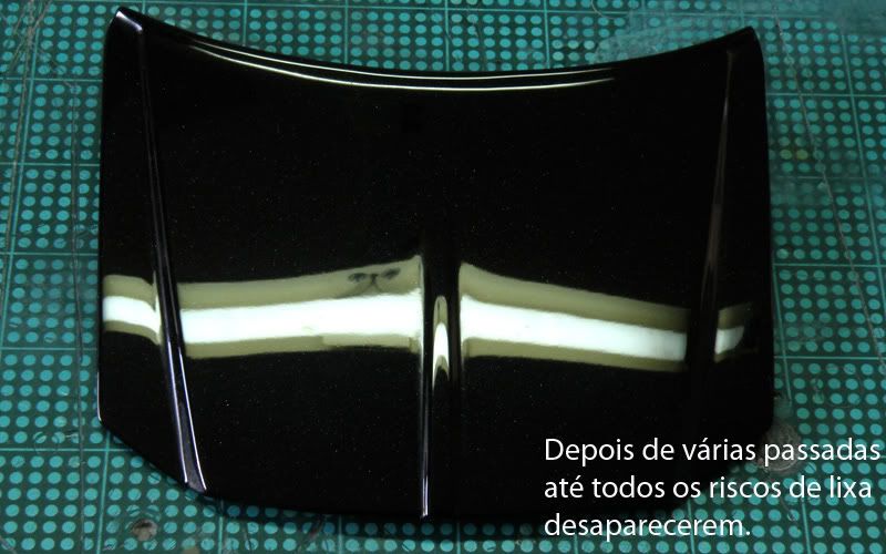

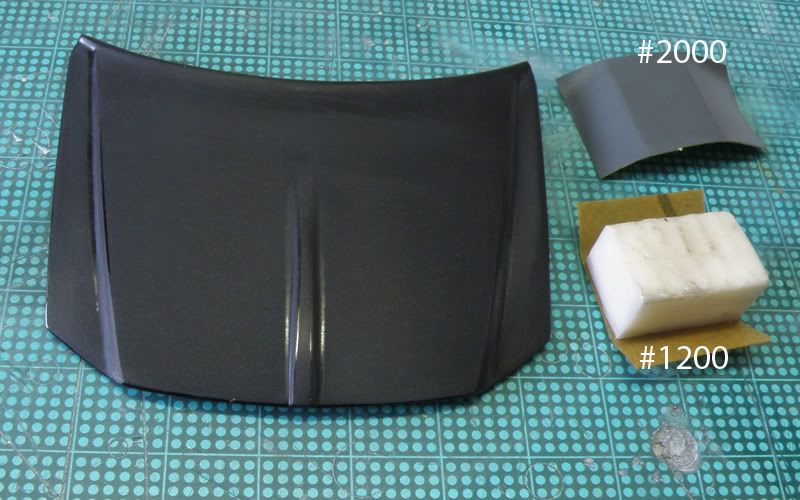

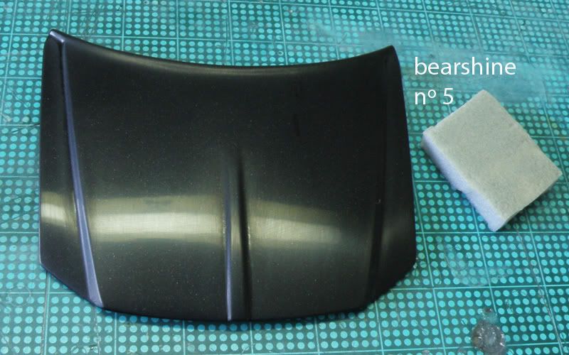

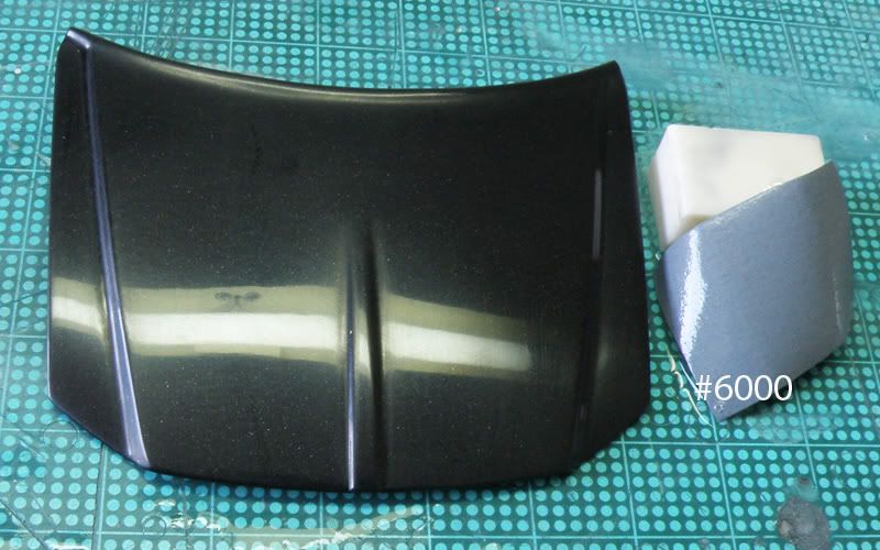

Bossolani
05-12-2011, 07:28 AM
Guys;
Sanding process wich I doing are grit #1200, #2000, #5 esponge pad, #6000.
http://i122.photobucket.com/albums/o278/bossolani/Magnum/magnum_42.jpg
http://i122.photobucket.com/albums/o278/bossolani/Magnum/magnum_43.jpg
http://i122.photobucket.com/albums/o278/bossolani/Magnum/magnum_44.jpg
http://i122.photobucket.com/albums/o278/bossolani/Magnum/magnum_45.jpg
http://i122.photobucket.com/albums/o278/bossolani/Magnum/magnum_46.jpg
Compound from 3M... actually you could use anyone water based... with rotary tool.
With my fingers applying car wax water based... any brand...
So, I'm finishing with Tamiya wax.... with fingers also.
http://www.hiroboy.com/catalog/images/tam87036.jpg?osCsid=360c5893bcbca60c0d3df1e60c1386 51
It's a simple sequence... great results you can obtain.
Cheers!!!

I'm a little concerned between the wool and cotton. Won't the 2 different materials have a completely different heat dissipation reaction? Won't wool be MORE heat than cotton? These 2 images show 2 very different materials:
http://www.blattsbargains.com/prod_images_small/BZRogTQB2kKGrHgoH-EEjlLlyKFGBKl4m92o9_12.jpg
