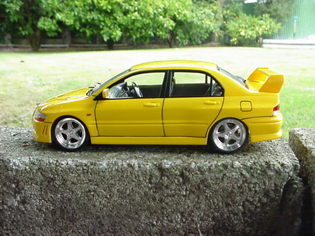

Hi. I typed in the search tool every keyword that came out from my brain related to painting the tiny lights, generally turning lights (orange) but sometimes are possition lights (red) or whatever color. The problem comes out when the kit does not include a clear part to be painted and fixed, but molded to the body instead.
I used to just brush paint in gloss orange over the molding, but itīs not a great "glass of a light" effect.
Iīm talking about that orange light on the side, between the front wheel and the side mirror (sorry to P-Man for using your pic to show this, and if itīs forbidden to do that just let me know so I edit the link).
http://www.automotiveforums.com/scalemodeling/pman/evo7x2.jpg
I thought of giving a white or silver base coat with the brush (just paint the "light" in white or silver) and then repaint over it with a drop of clear orange or clear red, but did not want to ruin a kit like that without knowing beforehand. Anyone tried this one?
How do you guys do this?
