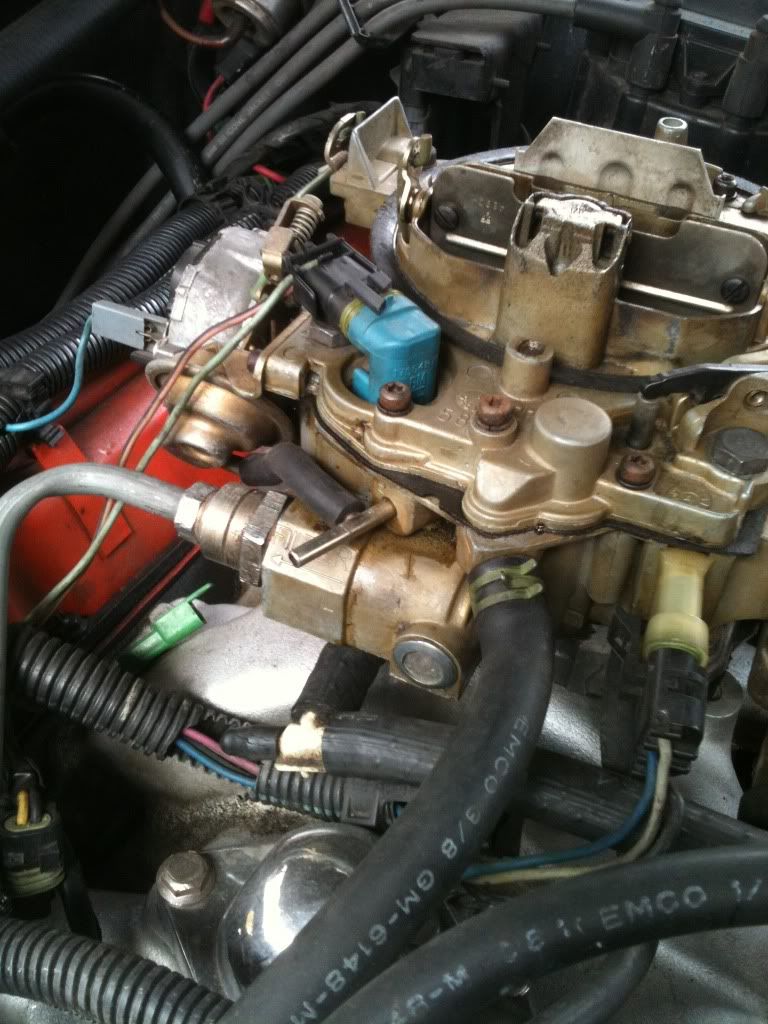

Wondering what that line coming off the front of the carb that isnt covered or plugged is...and what i should do about it...

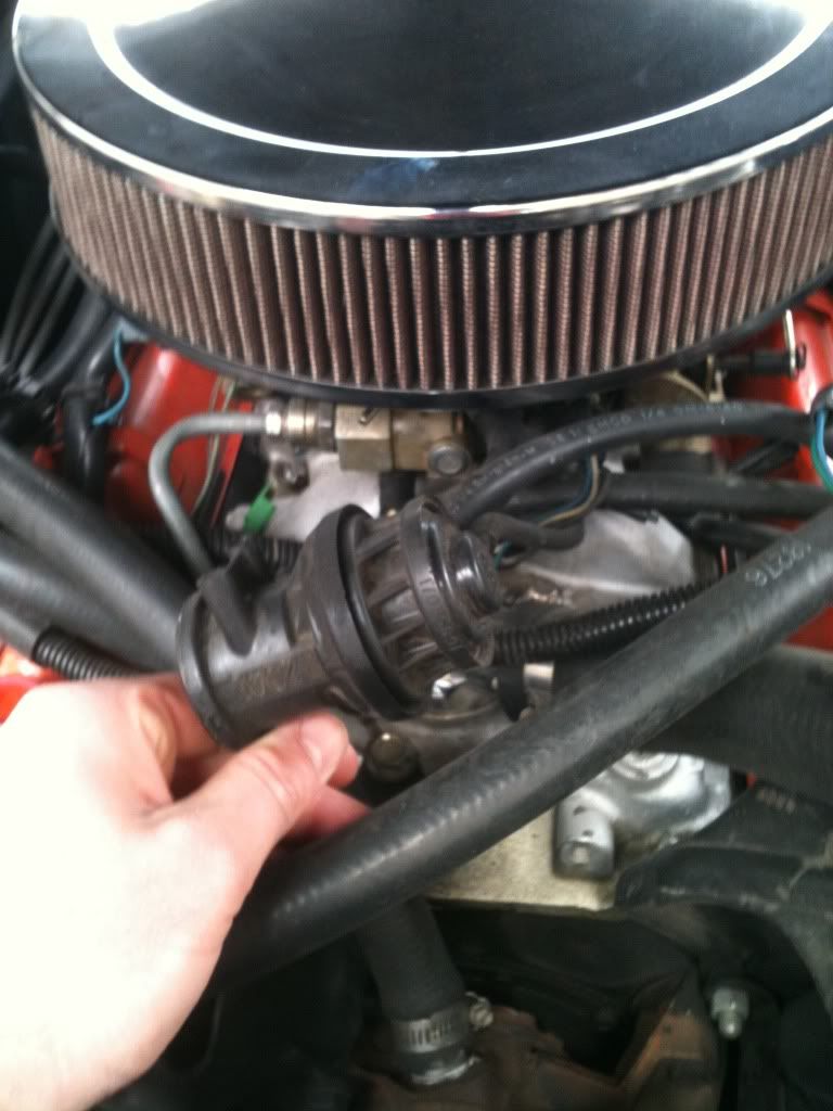

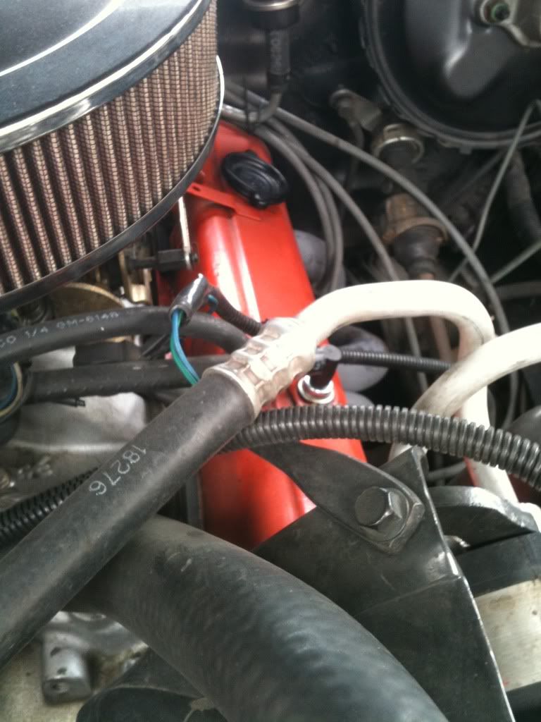

What the hell is this thing...ahah i know it attatches to the pcv valve but do i need it plugged and can i or should i just get a breather for the pcv valve...other options?http://i285.photobucket.com/albums/ll52/tohsiom2121/cap3.jpg[/IMG[IMG]http://i285.photobucket.com/albums/ll52/tohsiom2121/cap4.jpg

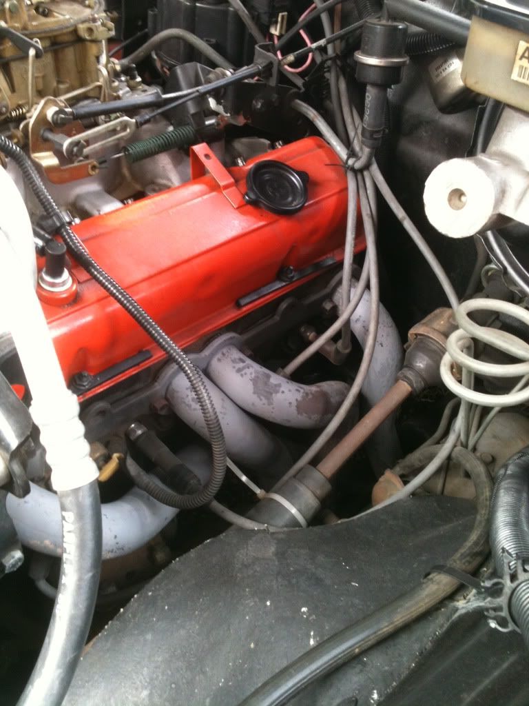

Should i get plug protecters...JCAT said something about them being too close to the headers...any sugestions...thanks for all the help guys...seriuosly really helps....lemme know

the wires need protection. insulate the header pipes with a header wrap.the wires looked cooked to me you must measure the resistance to see if still good and the rubber is not damaged...they also have a high temp wrap for wires..these are used on my 96 impala.
the carb picture shows cracked vacuum lines replace all cracked and hardened vac lines ..make sure you get all the correct sizes..
this I see has what looks like a T fitting with a rubber cap cracked avoid using the rubber caps to block off the plastic fittings as they fail quickly..
the plastic valve assembly that you asked what is this for is you cannister purge valve..this fails quite often. when it does it sucks fuel out of the fuel tank and will flood the carb...make sure it is not wet with gasoline...[internal diaphram ruptures causes this.........]

forgot to mention.....the carb tubing , that needs a vacuum line is for the OEM air cleaner...this would go to the air temperature intake controller..this keeps the air going to the carb at about 105 deg f...when this is dissconnected you have a very large vacuum leak and the choke pulloff will not work......
this heated air allows the engine to run smoothly when it is below 50deg f air temp...I am quite sure this engine must use lots of fuel and has a bad hesitation....I would also expect this engine to start and quickly stall unless you floor it to keep it running..

Just plug the open vacuum port at the top of the carb, as said, it would go to your stock air cleaner that you are not using. There is a procedure in the factory service manual that tells you how to check the canister purge valve, don't recall it off hand. If yours is old, chances are it's bad.
And yes it would be nice to have wrapped headers, but I would say the majority of people with headers do not, myself included. Just invest in some wire looms to keep the wires away from the headers, it looks like you need them anyway.
