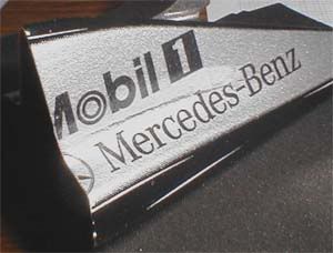

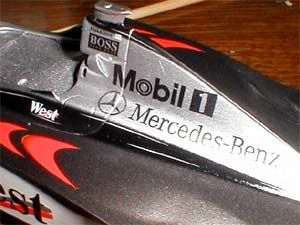

If you are lucky, you might be able to get a close match. I had to do the same to some of my models in the past, and the repaired area turned out
almost unnoticeable..."almost."

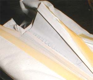

Fill the cracks, and do the usual body prep like sanding and priming. Mask the unaffected area, then apply the base coat. Pay close attention to the
area where new and old colors meet. Blur the neighboring area by leaving a slight gap between the surface and the masking tape. The idea is to
prevent a sudden transition of colors from new to old by creating a gradation from the top of the pillar to the side of the roof.
When you clear coat, widen the blurry area by increasing the gap between the surface and the masking tape (or simply re-attach the
masking tape), so the 2K clear area will be partially covered with the new lacquer clear. But I've heard that lacquer will affect urethane, so you must
apply the lacquer clear in several mist coats.
Once done, you should be able to blend the new clear layer with the old one by using very a fine polishing cloth (like 4000 grit and up) and a fine compound.
If this doesn't work, you'll probably have to give up and strip the paint.
