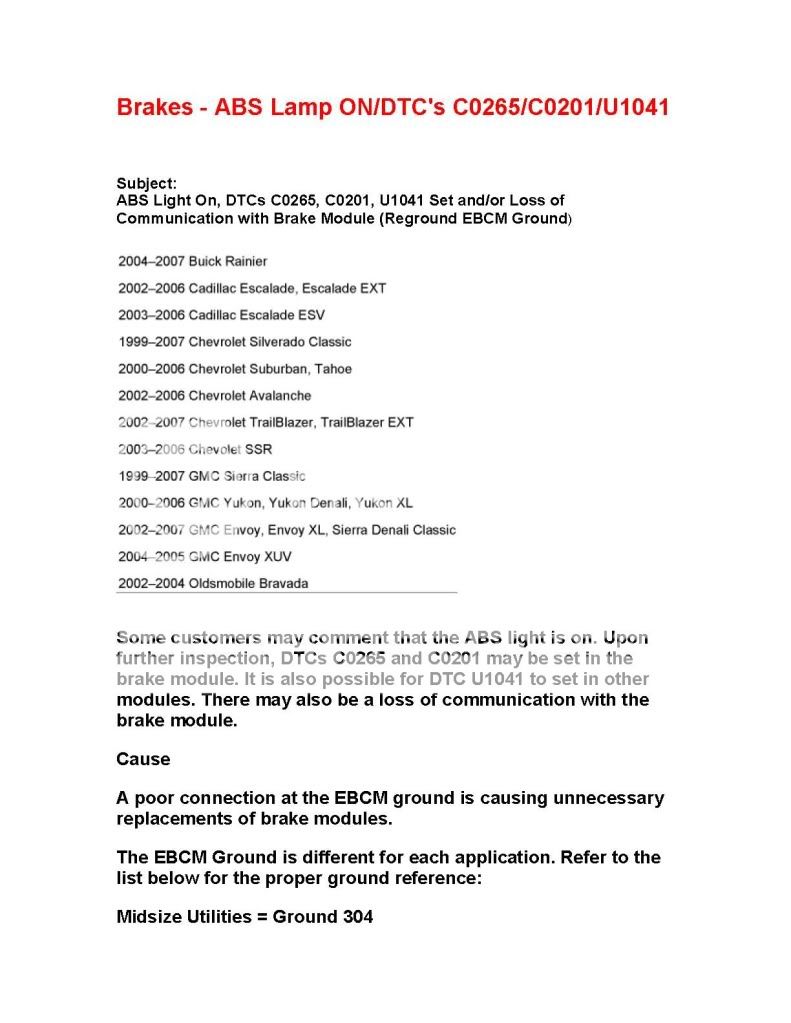

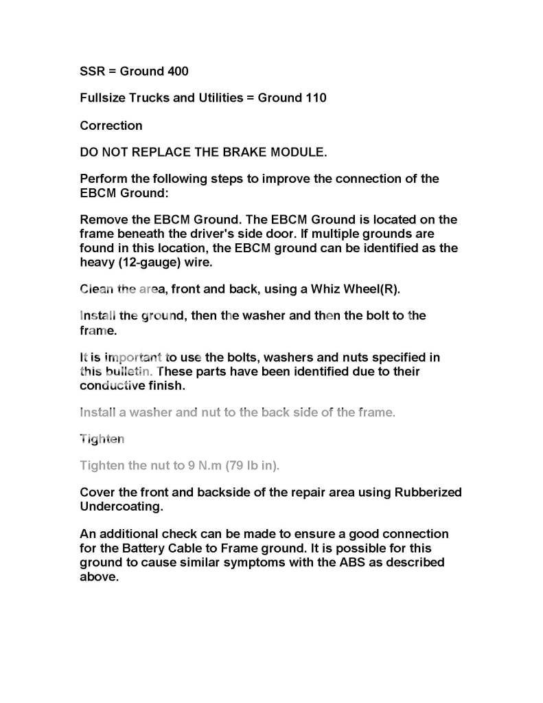

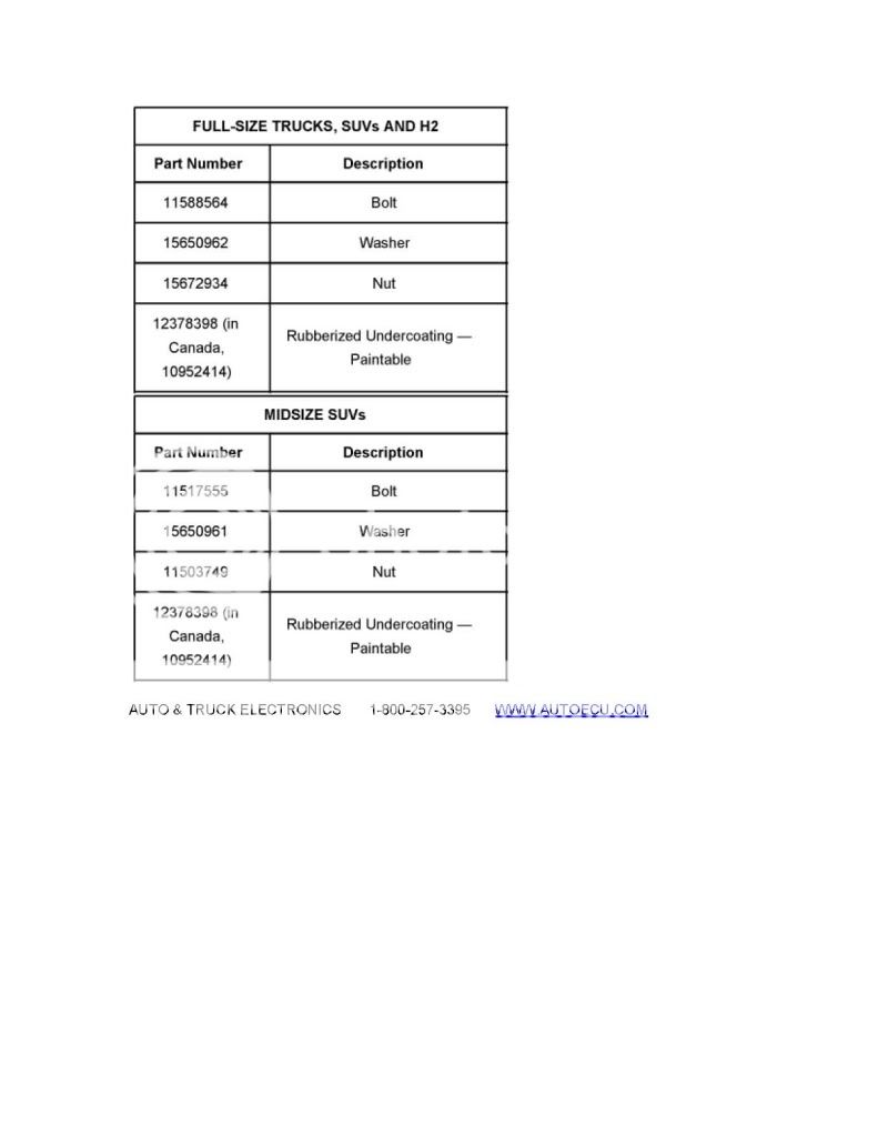

Even more interesting news. Stopped at local mechanic on way home last night. He ran the codes. Came up as C0265. Sent this to "Don" at [email protected]. Came upon Don on Ebay when I was looking for others that refurbish the ABS Module. Below is his comment:
Hi Will,
Your problem is most likely a bad ground at the Connection from the Pump to the frame. I have attached C0265 fault code for you to review. We have found when this ground is corrected, all worked well after a few key cycles and 15 to 20 minutes of driving. Hope this helps
Don
Here are the links to what Don's attachment said:
http://i309.photobucket.com/albums/kk375/DeweyDog/GMABSCODE265_Page_2.jpg
http://i309.photobucket.com/albums/kk375/DeweyDog/GMABSCODE265_Page_1.jpg
http://i309.photobucket.com/albums/kk375/DeweyDog/GMABSCODE265_Page_3.jpg
Very interesting if you ask me. If it is true, a whole bunch of very expensive ABS units may have been replaced unnecessarily. We'll see I suppose. Thanks for the help and I'll be reporting back as I discover items this weekend under the truck. Thanks!!!

blazee
03-30-2011, 10:36 AM
Wow, old age is catching up to me. I completely forgot about GM having those problems. The ground issue is a pretty wide spread problem and has caused a lot of necessary repairs.
http://www.automotiveforums.com/vbulletin/showpost.php?p=3708821&postcount=2
