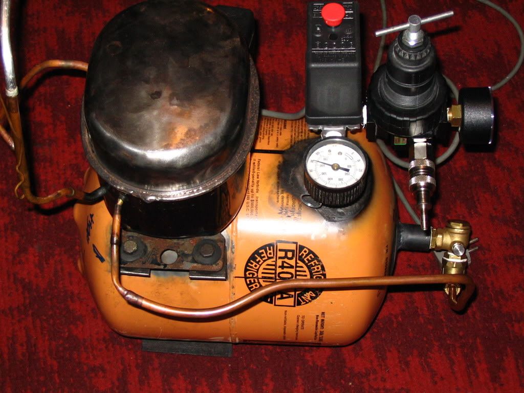

Here's the one I built back in 2004 and been using without a single issue since. The only difference to what you see in the picture is that the pressure regulator there did not work and I replaced it with a smaller simpler one that has a water trap incorporated in it
http://img.photobucket.com/albums/v68/ales12911/Misc/IMG_0026.jpg
What you see here is a compressor from an old fridge (free), a tank sourced through a friend (free), and automatic switch (ca $20), a couple of pressure gauges (one free, one about $5), some piping and other hardware including one outlet welded onto the tank (about $25 together with soldering), four angle brackets I made myself from an old piece of L-channel (free) welded onto the tank and the legs on the tank made from the same piece of metal (welding was free). The replacement pressure regulator was also about $15 from Ebay. There is also an $2 pressure relief valve under the pressure switch. At first I thought of painting it to make it look pretty but did not bother - it sits by my paint booth and no one sees it. It's fantastically quiet ad the tank is big enough for the compressor to be fast enough to keep the pressure up. By quite some margin, I might add. The only time you hear it, really, is when it switches on and off. Hope it's helpful in some way and as Khier said, the old fridge compressor option is perhaps a better one than the noisy tyre compressor.
