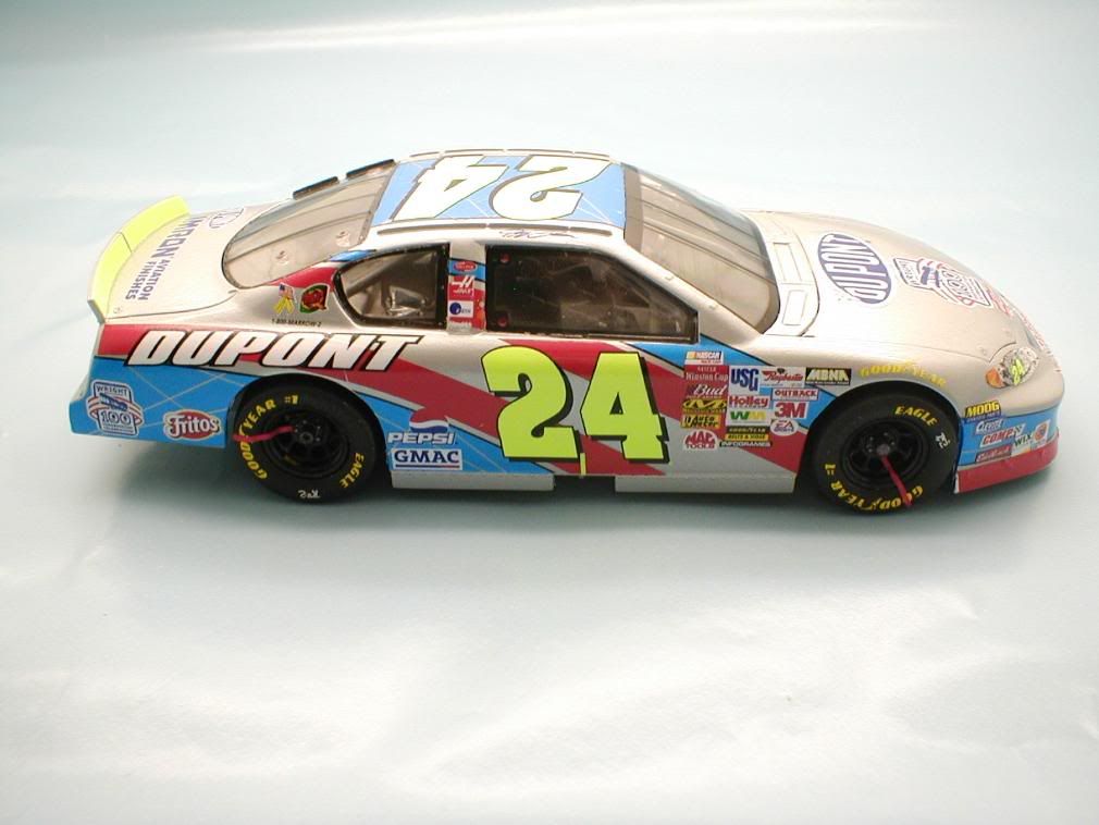

Yes, lacquer works just fine on tires.
Not the best picture, but the best I could find in my pic albums. The tires on this car were done w/ Lacquer. Gloss clear the tire, put down any decals you need, and then flat clear the tire, and it looks excellent.
