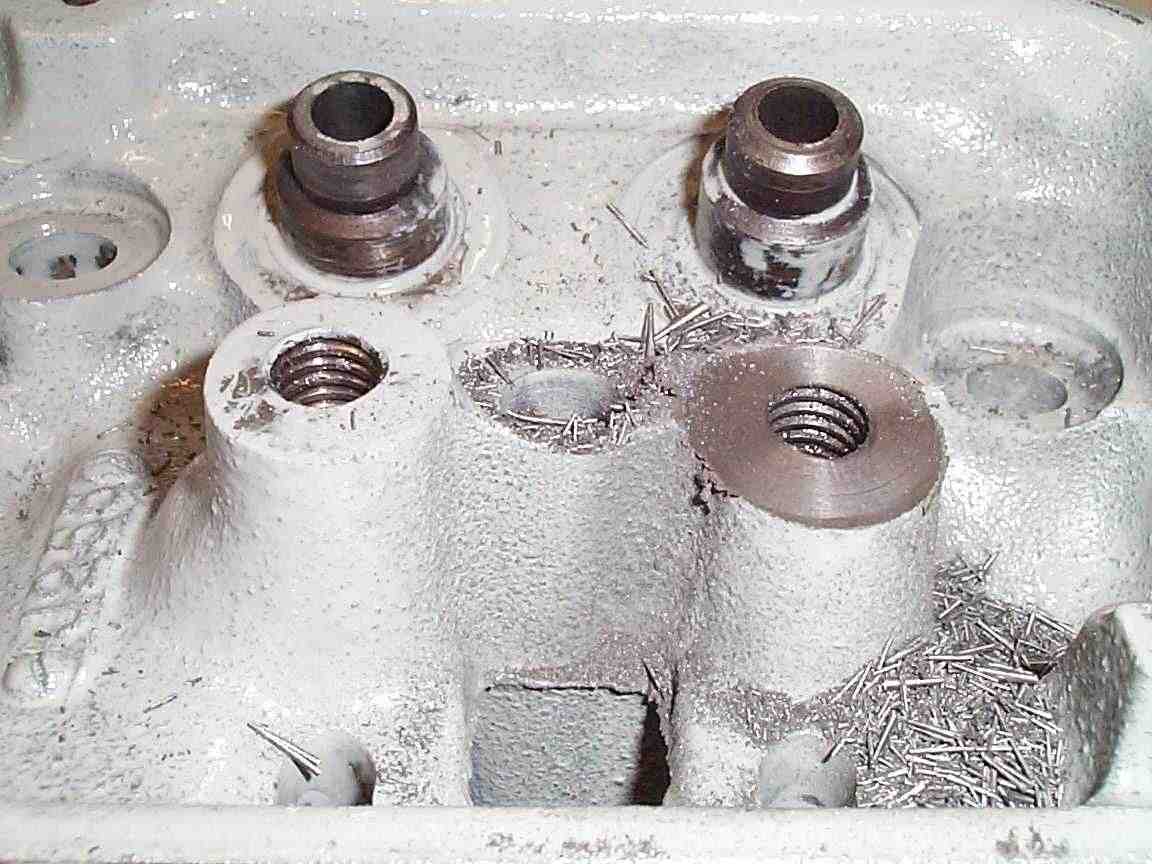

It would probably be best to remove the heads for re-tapping, then cut down the stud bosses to allow use of either type rocker. Of course, using net lash rockers would require a locking nut/top lock or something to retain adjustment better than stock self-lockers.
Once you tap the stud bosses for 7/16-14 you can do about anything you want.
http://www.wwdsltd.com/files/StudBossCutting.jpg

You could tap by hand but would need to be extremely careful to tap straight. That also wouldn't solve the bottom clearance problem for the hex collar on most studs, but you could try to locate collarless studs like Mr. Gasket used to offer.
duh1
03-07-2011, 01:01 AM
I'm confused, the heads are already tapped, and, have studs withe hex 'collars'. The only problem is that they are a smaller metric, not 7/16ths. I was concerned about keeping the tap straight though. hmmm, from the pics i think i see what you mean, well, thanks, i guess i'm going to have to do more research.
