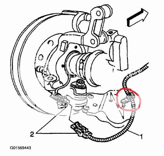

I plan to replace both lower control arms in my 2002 Buick Regal LS in the next few days. In the GM repair manual, they recommend that the abs harness fasteners (to the lower control arms) should be replaced if they are not clean and free from rust. I decide to replace these fasteners for the peace of mind. Can anyone please tell me what the part number is and where I can buy these fasteners from? How many fasteners will I need to order for each control arm? Thanks.
The below picture shows the fastener circled in red:
http://i619.photobucket.com/albums/tt279/Tho_Thanh_wedding/car/abs_harness.jpg

http://www.harborfreight.com/40-piece-black-nylon-cable-clamp-set-67541.html

Thanks a lot. I have picked the similar ones from a local part store today.
