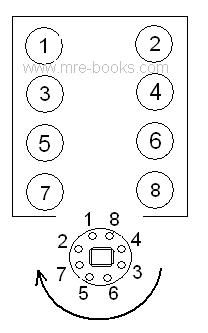

I'm not sure if you will wire the engine but here is the typical firing order for the engine MerlinPro stated.
http://i9.photobucket.com/albums/a99/quadzero/all_small_blocks.jpg
262, 267, 283, 302, 305, 350,
400 and 454 CID Engines
1975-1991
And as MerlinPro said, a Chevy small block is probably the most popular engine for most hot rods, no matter the make. Good luck with your project.

Thanks quadzero, yes im going tu wire it, i want to do something very detailed....let see what happens, when i start the project i will do a post on "WIP hot rod"
Bye!
