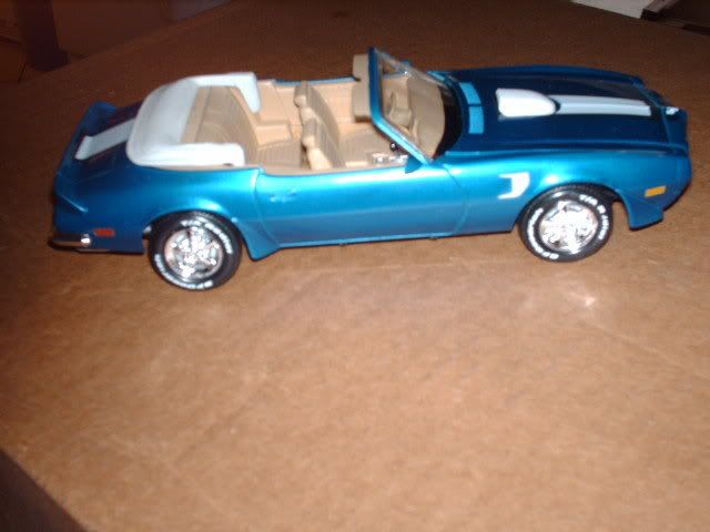

I use plastic polish. Bare Metal Foil used to sell a plastic polish that is even great on rubbing out paint but they no longer sell it. I bought up all I could find. It is the best polish I have used so far. Get a kit for taking scratches out of CD's. I don't really like the Novus products. I just got a plastic polish from Griot's Car Care but I have not tried it yet. www.griotsgarage.com (http://www.griotsgarage.com) It has a strong wax smell to it so I'm not sure I'm going to like it either. I'm pretty hard to please. I do resin casting. I will spend several hours just polishing and doing the prep work for a part. Mainly and especially a window part. I like to polish most bodies as it helps the part come out easier and makes the mold last longer. I have painted bodies with nail polish and wet sand with 2400 grit cloth and polish with the BMF. It looks pretty good. I built this 70 TA fake convertible. Painted and polished as described. Used a 57 Chevy 1:25 scale convertible boot from another resin kit.
http://i63.photobucket.com/albums/h140/plumberboy1/70TA7.jpg
