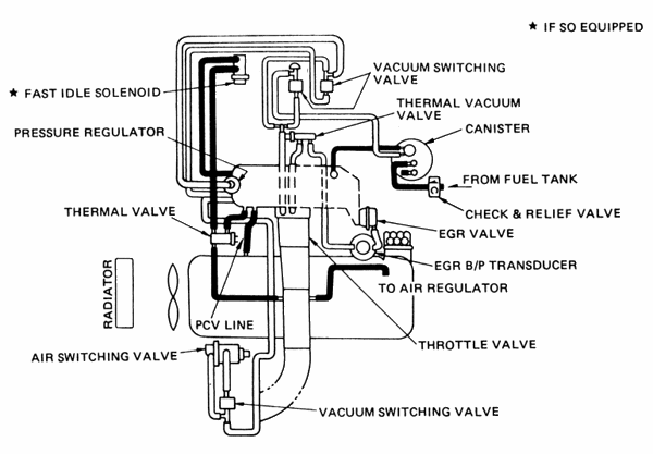

The biggest issue with old 2.6's is Vacuum lines. they dry rot and it will run rough. Other than that, a good tune-up would be advisable as well as oil/filter change. When you are ready to do the vacuum lines, let me know and i'll send you a diagram that shows where all of the lines go.

I went up to my local auto parts store bought all the belts and radiator hose plus the repair manual. I cant wait to begin working on the trooper. I believe my grandfather has bought all the vacuum lines i need. it would be much appreciated to get any help with diagrams for hose hook ups or any other advice you have for me. I will be posting pics of the trooper when i get it and as i make progress with it.

Here ya go!
http://i741.photobucket.com/albums/xx55/sassee_photos/698682481_XoueT-M.gif
I also have good digital pics of my black 89 if you need real life images. just let me know.
