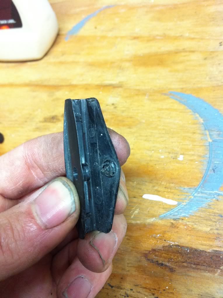

Both my windows on my 2 door fall forward if not rolled up all the way. I can't figure out what is broken. Video below; I know there's a missing bolt there but that's not the problem.

I think I figured it out:
http://i121.photobucket.com/albums/o219/ernestmayhand/Caprice%20resto/907dabd2.jpg

Yup. That's it!
I replaced those when I replaced the window channels/felts on my 89.
Had the same problem.

Yes indeed. Window guides. Get these from your GM dealer, the Autozone ones don't work well. As a bonus, they're actually CHEAPER through GM.
^^X2 on that.
I also had to replace those and was surprised that you could get out of the dealership parts dept for so little $.
^^X2 on that.
