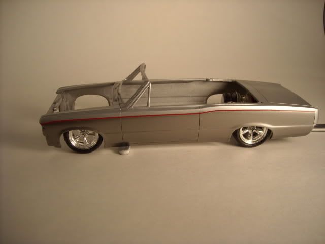

I've used Kustom Kolor with some success. Compatibility is the key. As Zoom Zoom said there are some substantial compatibility issues. Kustom Kolors makes a product called a "Reducer" and product called a "Thinner" for the Kustom Kolor line. The Thinner drys slower than the Reducer and makes the paint behave sort of like an enamel in terms of gloss and drying time, although it still drys much faster than an enamel. The "Reducer" makes it behave more like a lacquer. It can also be thinned with lacquer thinner. Kustom Kolors Acrylic Clear does not work well over their paint and will definitely cause it to crack. I use Crystal Clear, an acrylic, over either thinned or reduced Kustom Kolors paint and I've had no bad reactions. My paint samples are over a year old. Here is a picture of a custom mix of Kustom Kolors over duplicolor silver. The body was cleared after I took this picture.
http://i187.photobucket.com/albums/x130/pharr7226/1964%20GTO%20Convertible%20Model/Painted64GTO038.jpg
http://i187.photobucket.com/albums/x130/pharr7226/1964%20GTO%20Convertible%20Model/Painted64GTO039.jpg

I used cheap hardware store lacquer thinner in my tests with no problems.

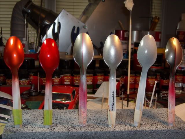

I agree that the marketing sucked. I bought at least 25 bottles, which partially explains my research and testing. I'm determined to explore every avenue to make the stuff work. I've also found that the thickness of the paint varies dramatically from color to color. Some colors, like silver, require as much as a 1:4 paint to thinner ratio while others require much less. You really can't use a formula to thin this paint. I thin it until I have the consistency of 2% milk. I've shot spoon tests with: candy red over various base colors; silver; black; and, custom combinations of silver and black. Some of my tests are over a year old and, so far, the paint is holding up.
http://i187.photobucket.com/albums/x130/pharr7226/Paint%20Tests/006.jpg
http://i187.photobucket.com/albums/x130/pharr7226/Paint%20Tests/007.jpg
These pseudo HOK paints are really a troublesome enigma of beautiful colors. I really wish they would have done a better job of making everything compatible and more user friendly. They just wanted to make a buck, and they did, I bought like 10 bottles of the crap and only one paintjob turned out nice enough to show (see my Infinity/Nissan Leopard/J30)

Damn those Red's look sick, thats the color Im after for my Supra build. What did you thin those down to? Im in the same boat as you, I was given 25 bottles of them and I want to make them work.
pharr7226
01-26-2011, 01:44 PM
Damn those Red's look sick, thats the color Im after for my Supra build. What did you thin those down to? I'm in the same boat as you, I was given 25 bottles of them and I want to make them work.
Thanks Rye 21. The orange looking color is actually candy red over a brass metalizer base. I just stopped shooting the red when I got the shade I wanted. The more traditional red is candy red over a duplicolor brilliant silver base. I don't have a precise ratio for thinning either color. The Kustom Kolor candies are much more reduced out of the bottle than the silvers that I referred to previously. I thin it to the consistency of 2% milk and test it. You only get one shot to get the candies right. In other words, you can't spray more paint to hide a mistake. The more coats the darker the color. In your tests make sure that it's not so thin that you get the spider legs effect. I hope this helps.
