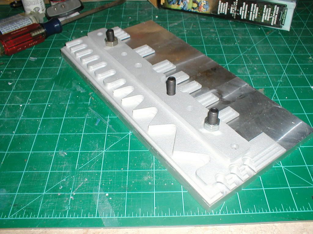

I have 2 bender tools, that I was actually able to design & make myself.
The first is very similar to the Mission Models Multi-Tool, but made w/ my own sizes, and its been pretty nice the few times Ive used it so far.
http://i257.photobucket.com/albums/hh218/RangerMach1/Models/P6110011.jpg
The second is a large etch bender like all the photo etch benders, but again I chose my own sizes and shapes & such. Its 12" long by I think 6" long. Unfortunately I wasnt able to get it 100% finished. The steps on the bender are 1/8" tall and I wanted to use a ballnose endmill to put a concave rounded edge, leaving about a .030"- .040" lip for a bending edge, but I ran out of time.
http://i257.photobucket.com/albums/hh218/RangerMach1/Models/P6110005.jpg
http://i257.photobucket.com/albums/hh218/RangerMach1/Models/P6110010.jpg

Thanks for sharing Adam. You're a very talented machinist and your tools look very effective.

Awesome machining work, Adam. I wish I had that kind of skill. I can barely turn out an oil filter on my lathe!
