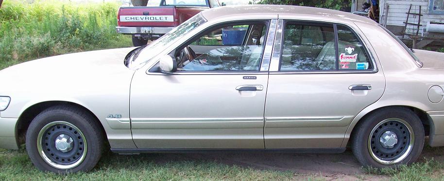

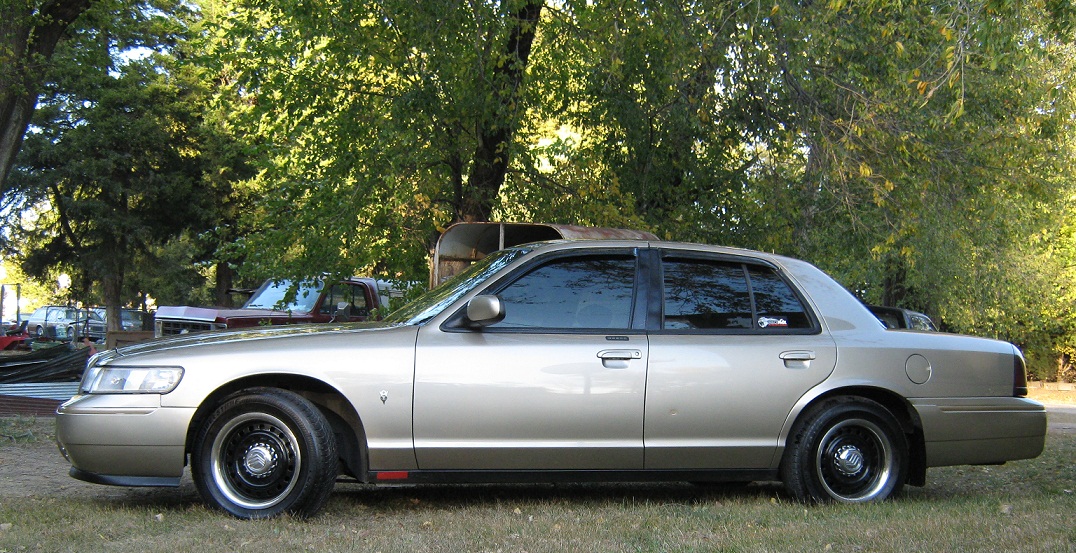

I'm not trying to get it real high. I want a little bit of a raked look but not huge. When parked next to CVPIs I see they're rear end stick up quite a bit more. At the bumper, probably a good 3-4 inches more than mine.
I don't want to go higher than what the CVPI rear end sits. The added clearance would be greatly beneficial to me and the look won't be bad either.
Blue)(Fusion
12-13-2010, 10:32 AM
Here is an example of what mine looks like (mine is covered in ice outside and don't want to trek outside just yet).
http://www.supermotors.net/getfile/841725/original/100_0148.jpg
Notice how the rear tire is very deep in the wheel well because of the old and weak stock civilian coils.
This is how I want it to look.
http://www.supermotors.net/getfile/836116/original/img_0893.jpg
I know the picture is taken from a lower angle but the wheel fender is raised about 1.5 additional inches over the tire to give it a better looking stance and provide better clearance over the ground.
Methinks those are just smaller tires...
Blue)(Fusion
12-13-2010, 01:47 PM
I spoke with the owner of that car. Those are the same wheels and tires, just cleaned up. He put on HAP (H code) police springs which are the highest riding (but not the stiffest) factory police springs offered by FoMoCo. I'd get these, but they are $100+ a piece now that they are discontinuing the platform versus the $40 they used to be. The only cheap coils still offered by Ford are those for the CNG powered police interceptors which are the tall and very stiff which I do not want to use with my stock front suspension. I can imagine the ride would be extremely unpleasant and oversteer like crazy unless I kept 300 pounds of tools in the trunk at all times. For fuel efficiency purposes, I do not want to do that, either.
