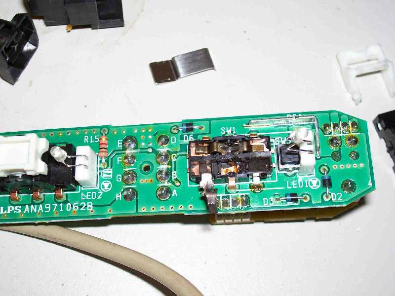

You'll likely have to pop the console out of the armrest. The year will determine what wire colors to jumper out or how to repair the switch. There's little else to do since it's the driver side window.
This is from a 2001 W-Body. Other years will differ:
http://www.wwdsltd.com/files/2001W-BodyWindowSwitchDetail.jpg
The toggle can weaken and the contacts can get damaged from moisture. Sometimes they can be repaired, as in this case.
