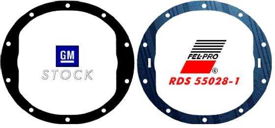

Blue Bowtie
11-19-2010, 09:19 PM
Good info from the Master.
If you do get new diff cover gaskets, make sure you get an aftermarket rear cover gasket or alter the factory gasket to open the oil holes from the axle tubes:
http://www.wwdsltd.com/files/DiffGasket.jpg

No, Old Master . . . completely forgot about getting gaskets. Thanks for the reminder. We are about 3 hours from Detroit, sure wish this cold snap would get over. Thanks Blue Bowtie for the reply. Good info about the gaskets, seems like Fel Pro would be the way to go.
