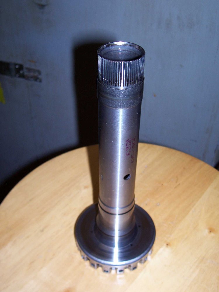

Oh, c'mon. You must be exaggerating. Is it even possible for this meaty beast of a "shaft" to strip?
http://www.wwdsltd.com/files/4T604thInputTube.jpg
I mean, this massive shaft is at least as robust as a toilet tissue tube, maybe even more so... ;)
I'm just trying to test all the possibilities before opening the side cover.
