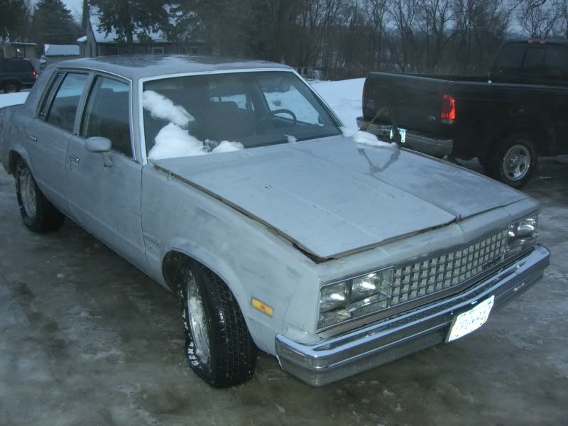

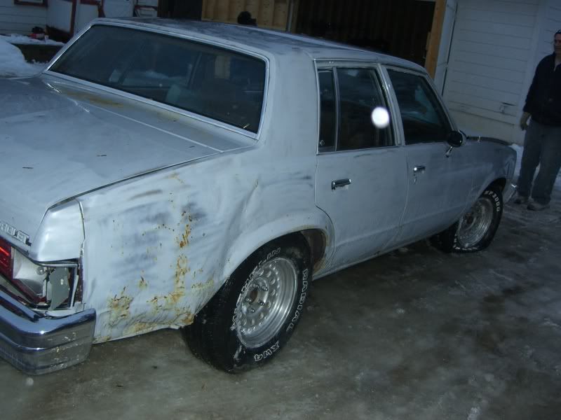

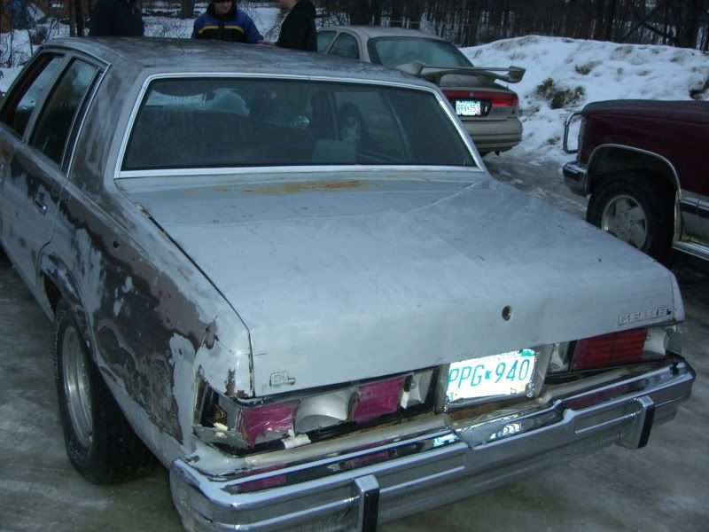

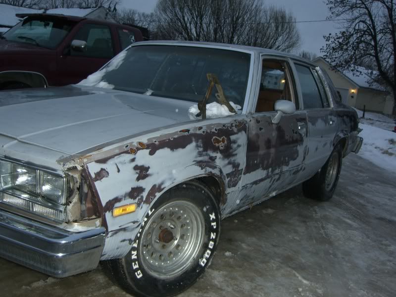

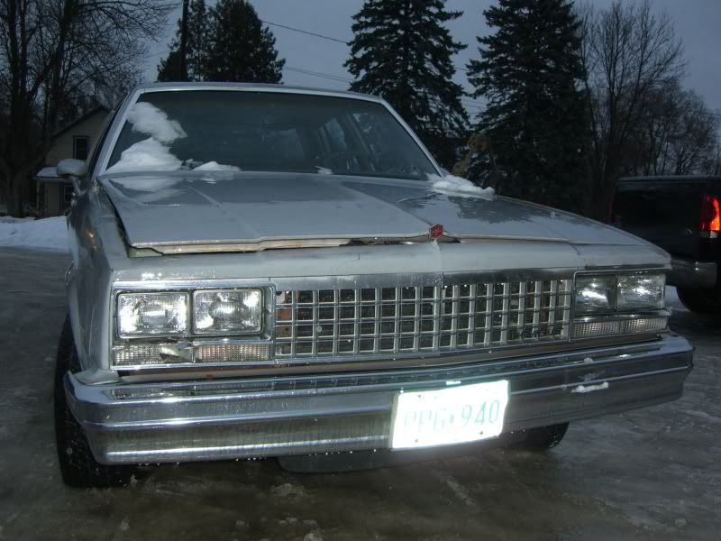

Here are the pictures of the car, thought it might help.
http://img.photobucket.com/albums/v489/ShogoKawada/Dec2009-Jan2010329.jpg
http://img.photobucket.com/albums/v489/ShogoKawada/Dec2009-Jan2010337.jpg
