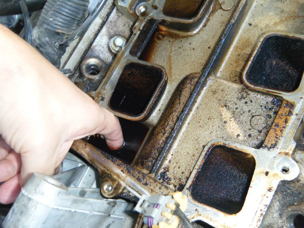

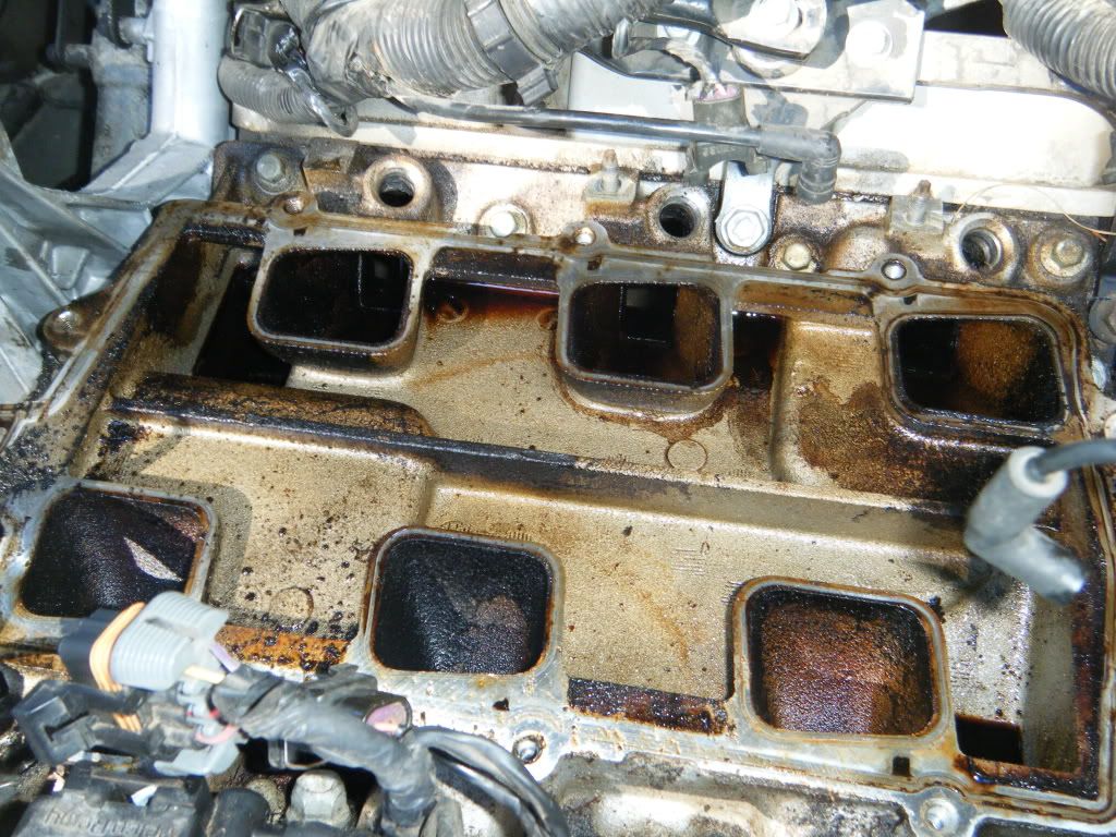

I have been having surging probs with my LSS '96 non-SC for a while. It has 84K. After changing alot of diff items (IAC, TPS, PCV, water pump, fuel regulator) and the surging continues. I couldn't find any vacuum leaks , so after research I decided to go to the intake. I have successfully removed the intake and there seems to be a pretty good amount of what looks to me ,oil. Might have some coolant in there too. It is puddled up where the hidden bolts for the lower are located.
Can I clean this gunk up in the intake with Carb cleaner?
Should I look at other parts? (lower)?
Does this look like it was deffective and could be causing the surging?
attaching photo's

I have never taken an uim off without that puddle of oil in the corners I always seal those bolt threads and that stops, but you do not have a real diagnosis for the surging which can be caused by other issues than a bad lower gasket or upper intake, usually that is not a symptom unless they have severe vacuum leaks.

I noticed upon removal that there seemed to be a leak of coolant need the throttle body connection and the little tube that runs in the intake connect to that MAP seemed to be out of position. ?????
should I refill the coolant sytsem with reg coolant and not the dexcool?

To change from Dexcool you will need a thorough coolant flush so as to not to mix old and new. I'd stay with Dex myself./
