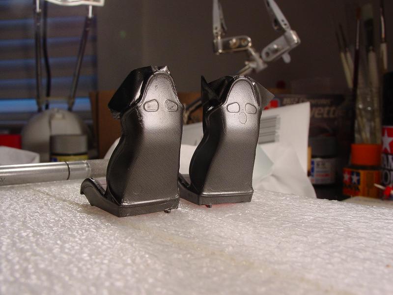

I just make sure I cut the decal big enough, you don't want to make it too small otherwise you will have to use more than one decal and you will see the overlap
i also use a decal setting solution, it works wonders
http://files.automotiveforums.com/uploads/657432DSC04486.JPG
http://files.automotiveforums.com/uploads/349095DSC04498.JPG
Like paint, carbon fiber decals hide nothing, it is best to fill any sink marks or ejector pin marks before applying the decals. Failing to fill these actually makes them stand out more one the decal is applied.
SupercarFreak
05-13-2003, 02:30 PM
i noticed :( this is my first model
i will try to remove all molding lines and stuff on the body
